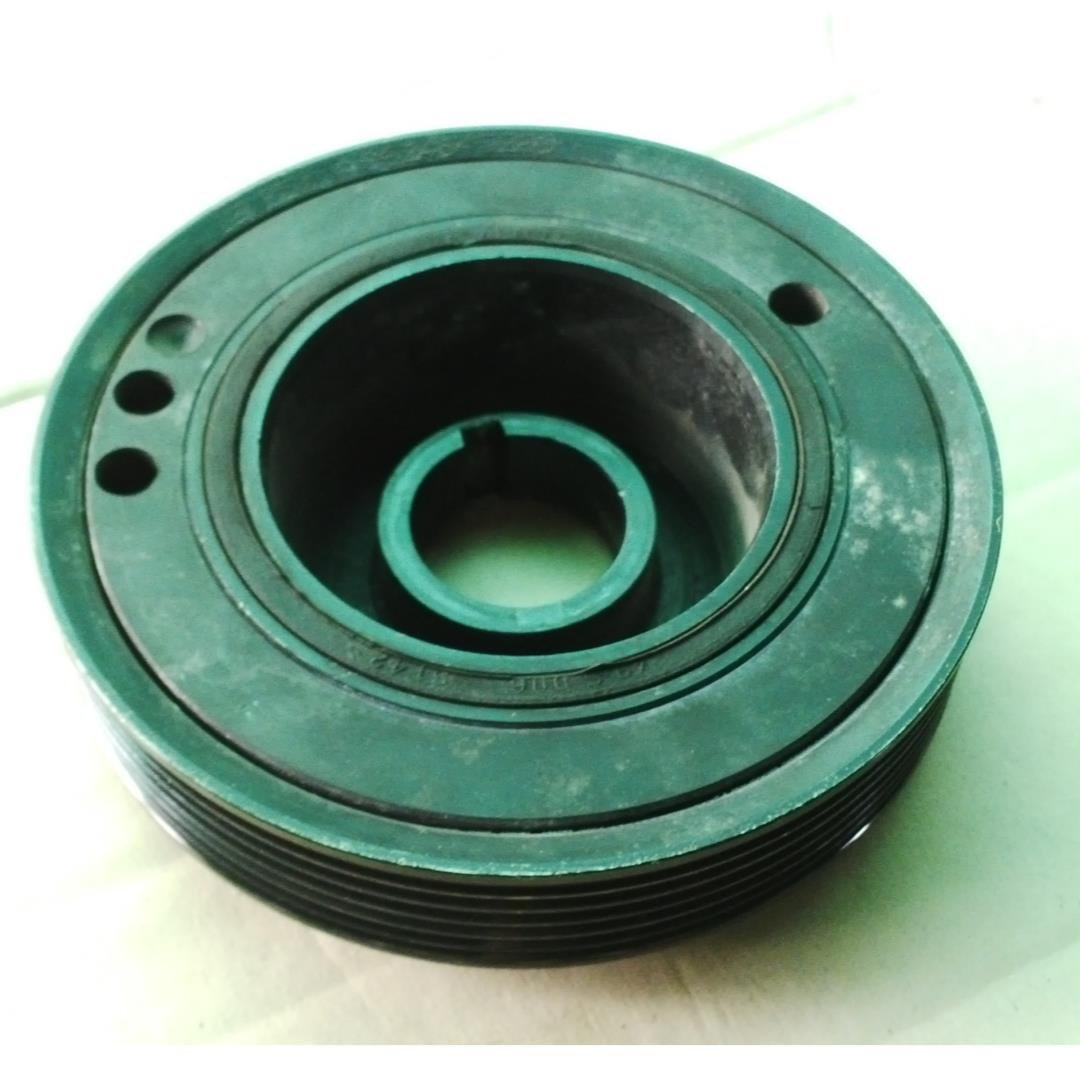

Timing pins is the only way to set these engines up correctly. BUT BEWARE ! the crankshaft pulley starts life as two metal parts, with a bonded rubber damper in the middle. With age the outer part with the timing hole can move, so the timing will be out.
Before dismantling fit all three pins to see if it all lines up correctly. Better still use a new crank pulley.
