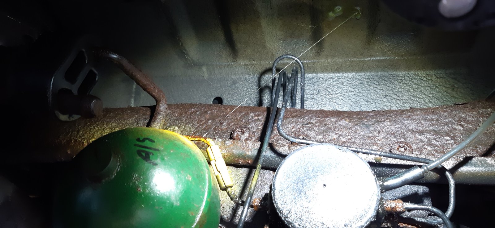

Hi Everyone, My Green Xantia Estate 1.9TD, N Reg, has just sprung a leak from the pipe that exits the rear height corrector, crosses over the rear accumulator and goes into a K junction on the side of the accumulator mounting. Not a big run and the junctions look easy to get to although they are very rusty and will probably resist being undone. I've been looking around and can get lengths of 3.5mm pipe with the junction nuts attached to properly flared ends. However, I'm not massively confident of bending these into the correct form. Are they rellatively easy to bend, successfully? If they are, and I assume they must be given that people sell unformed lengths, any tips or pointers on getting the job done? If it seems easy enough I'll probably do all the short lengths around the height corrector at the same time. Typically, the car has only recently passed it's MOT.

No problem in bending 3.5mm pipe, so long as you curve it gently around a former (eg another curved surface), or use a hand-held pipe bender. Just avoid sharp bends, which could cause the pipe to collapse.
Use new Citroen rubber joint seals on the unions, and ensure that the tip of the steel pipe squarely enters the K- etc fitting, so it enters the 3.5mm central drilling. Lube with LHM when fitting, and tighten, but don't overdo it.
Does look in need of some wax protection under there!

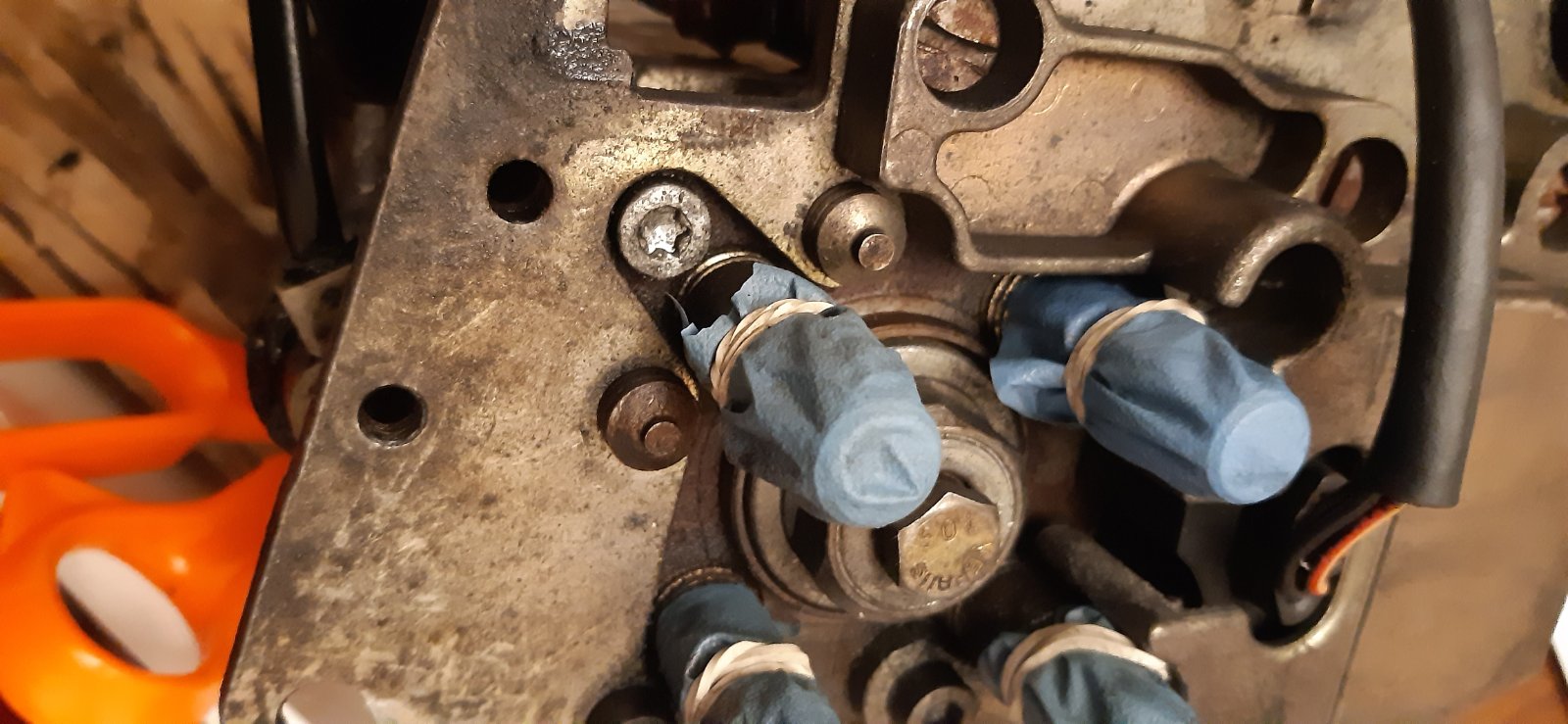

Re: Can you Bend 3.5mm Hydraulic pipe?
Hi, thanks for the reply. I'm okay for tools for standard security, hollow bolts. I've attached a photo to show you what I mean by 'dome' heads. I admit I'm at a loss on how to approach these things.
Tom
I can see standard torx head screws there, and a couple of slightly suspicious-looking straight-slot screws. Would not expect to see the latter at all . . . they just aren't used on our cars, so far as I know. They're already burred, which looks as if someone might have been there before.
The "domed" items don't look like assembly fixings at all; are you sure they're not just end plate location dowels? Could be wrong.
Re-assembling and re-sealing these pumps (with the full pukka seal kit) is a fairly specialist job, which any good diesel-specialist workshop would do, and for a fixed price. Might be worth looking at? In 2020 I had my Bosch inj pump on the 2.5 XM professionally overhauled (it had a leak) at a cost of just under €300.
I'm with Chris on this one, never seen a slotted machine screw on a PSA part. Also the domed headed 'things', the only way they could be fixings is if they were the type that shears it's head on fastening. The plate with the slotted screws seem to be sitting on top of or part of the plate with the domed 'things' so would have to be removed first regardless.
