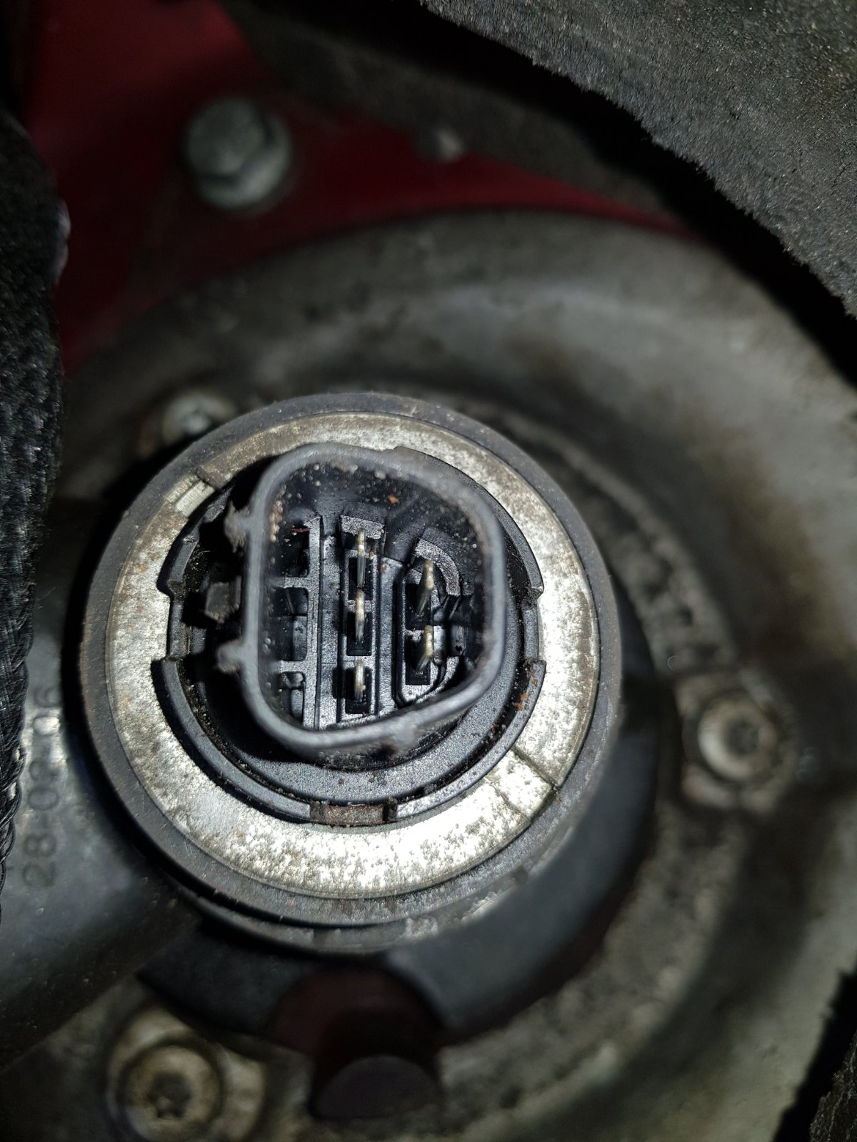

Re: front suspenion problem
@ Marc:
Marc i have a question, i hope you can help me.
From this strut c6 amvar i'm looking for the elektrical connections i remember, that i have seen it one time, but i can't find it any more.
greeting,
Kees.
greeting,
Kees.
Kees
- Posts: 602
- Joined: 16 Nov 2021, 16:16
- x 148
To make it clear i want to know the number of the pins, because i know the relation between the number and the power suply.
greetings, kees.
greetings, kees.
- x 6945
Kees - you have to ignore the electronic part and just use the strut. The AMVAR function from the C6 was never incorporated into the X7. The harnesses are not there, neither is the software contained in the suspension computer for this function, so won't work. Just ignore the socket and cover it up.
