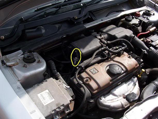

i'd still maybe take a look at that MAP sensor connector,see if you can repeat the problem by wiggling the connector.i'll try & find a pic of its location to help you.
