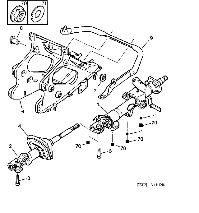

- Posts: 10973
- Joined: 09 Nov 2005, 22:03
- x 1459
Re: Citroen xantia intermittent heavy steering
Therre are 2 joints in the steering column, one inside the car, and one outside. It is the outside one (2 in the diagram) that needs lubrication.
After spraying grease at the "number 2" joint generous amount, sadly it didn't help.
