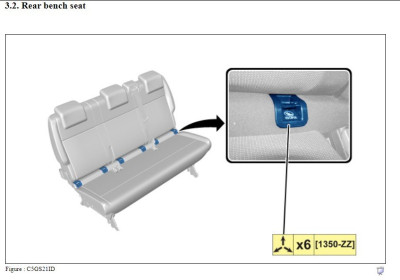

Re: dispatch 3 crew cab isofix
Firstly according to that reg this is a Dispatch 4 (K0) not a 3 ??
I can see anything specific to say if this vehicle has them or not but looking at an image from the repair manual they should be pretty obvious if they were there & it shows them on all three seats.

Sorry 4 my mistake... Yes the 9 seater is like that but all the crew cab vans are without the mouldings in the seats... I assumed like our other car there was a bar in the seat join?
