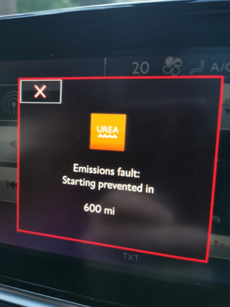

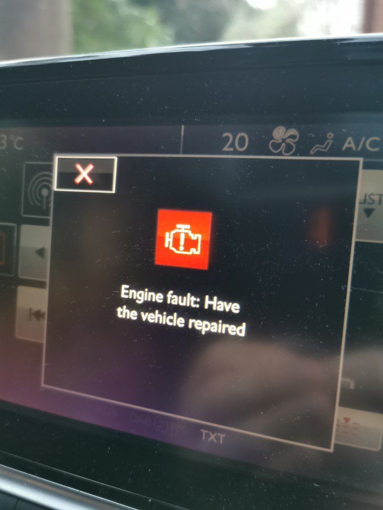

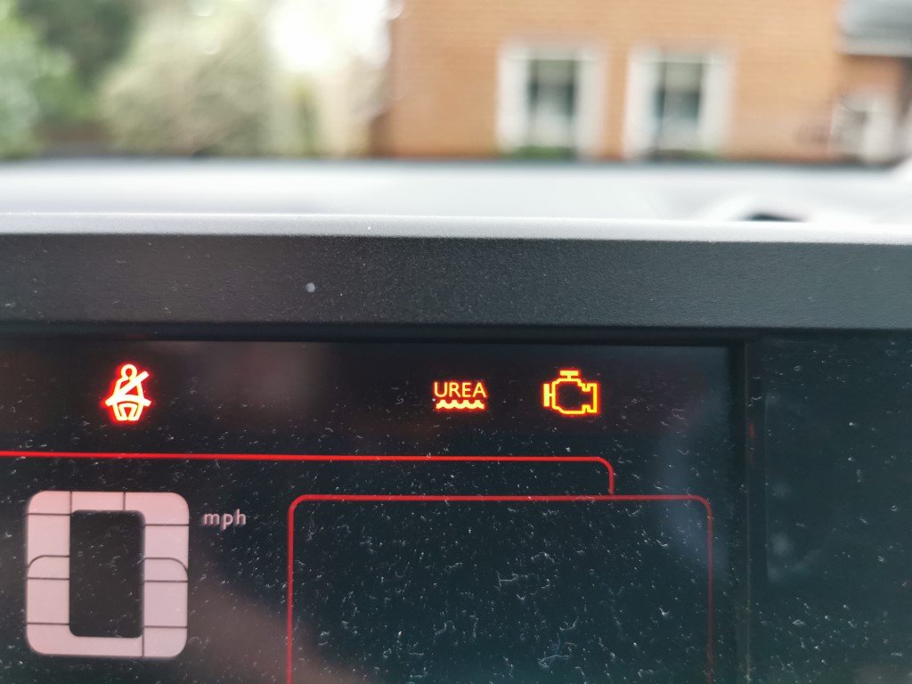

As mentioned above a short while into a planned trip down south from Yorkshire some messages appeared on the centre screen along with the engine warning light and a flashing UREA light on the display where the speedo is...
"Engine Fault: Have the vehicle repaired"
"Emissions Fault: Stating prevented in 700miles" (photo taken at a stop later, it counts down 50 miles at a time)
Engine light and the UREA light which is flashing, the "SERVICE" light is also on.
I knew there was plenty of UREA in because I'd checked it recently after the "smoke" issue, car was running OK so we carried on with the journey and tried to book in with a Citroen dealership at our destination, sadly they didn't respond to calls and messages but as it was New Year they were probably closed.
I topped up the UREA and got 9L in before setting off north again. The car got us back home OK with 300 miles left on the countdown, performed flawlessly, 58mpg average, just the constant message on the centre screen, even while using the reversing camera which seems a bit silly.

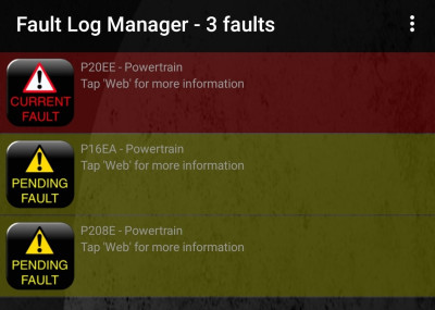

Once home I pulled the codes in Torque, (for some reason FAP wouldn't connect with the adapter that had worked previously so I might be missing some bits - should I invest in DiagBox? I keep seeing it mentioned but have no knowledge of it) but I have these ones:
P20EE - Powertrain
P16EA - Powertrain
P208E - Powertrain
I'm not going anywhere for a bit but will try to get it looked at properly but the thought of having to spend a small fortune on a car I've fallen out with and want to sell is making me incredibly sad so I thought I'd post here so you could make me feel even worse with your knowledge of similar issues and projected costs or just to get some thoughts from those of you with more experience of these cars than me as to what might be the at fault here.

I'm afraid we're not going to be much help here, but these are the general meanings:
P20EE: Depollution of the deNOx system: Emission control ineffective. Officially, they will Check to see if the engine management software is up to date and apply this if not.
P16EA: Depollution of the deNOx system: Excess emission of ammonia. There can be a multitude of sub-codes for this fault, so no further info as to the exact cause, but can be the Urea pump, the Urea injector, the NOx sensor or the pump itself.
P208E: DeNOx system circuit: Detection of a blockage. The fix is not known specifically, as this will be determined at the end of the extensive guided diagnostic test (that you won't have access to) undertaken by the dealer with this fault code.
So you're between a rock and a hard place:-
1) You can't sell the car like this and if you continue to use it, the vehicle won't start when it reaches the mileage limit.
2) Even though it is out of warranty, Citroen have been known to make goodwill gestures for their customers with these UREA tank faults. They have replaced these under good will - but if this is going to happen, this can and will only be done by a main dealer after they have diagnosed and followed the guided diagnostics - as they need to do this to make a credit claim back themselves against the manufacturer if it is found to be the tank.
So my advice is - save yourself wasted time and money using an independent garage that does not have the equipment to properly diagnose the fault, and even if they did, there's nothing they can do except charge you for a new tank and fitting it - but even then there is no guarantee they know how to undertake any initialisation of the NOx system or other components.
You may find that by talking nicely to your dealer, Citroen may make a contribution towards any replacement or work involved - even if out of warranty, but you may be charged for the diagnostic first of all - which let's face it is required as they have the proper equipment to do this. Once they confirm the fault codes above, they may be able to make a claim for any work.
So you have nothing to lose at this point, but don't waste time driving about to other garages.

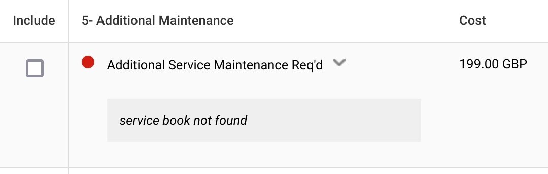

At around 5pm I received a text with a link to a summary of things they want to do on top of the £144 diagnostic it went I for...
1. Initial diagnostic led the tech to a technical bulletin, they want another £144 to look at this because car needs to be up to temp.
2. They want £199 because they couldn't find the service book in the car (it's not in for a service, the book is in the car though).

Not sure about (2), that can't be the case - they can't charge you £200 to look for your service book
(3), (4) & (5) are optional - so I'd get them to stick to the original fault.
If you're not happy, speak to Citroen Head Office and tell them what you have paid, what they are wanting and tell them you are not happy that they are not dealing with the specific issue regarding the Adblue.
I appreciate that they may have undertaken a vehicle health check - but that should be on their time not yours, as that's not what you've paid for or took it in for and still have the 300 mile countdown remaining.

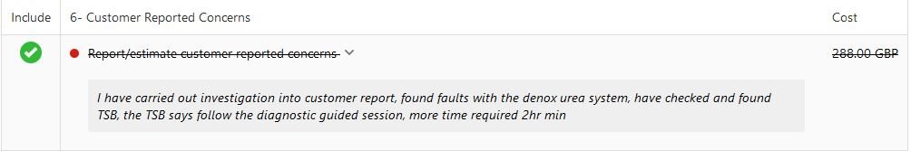

This is the "urgent" entry they are asking me to authorise:
They also provided a video walk around the car showing me things, oddly the incoherent chap doing it raised things the other chap didn't when they did the same "complimentary" check a couple of weeks ago. The same chap who didn't notice the white "smoke" that stunk of urea I thought I'd booked it in for that wasn't even looked at.
They aren't filling me with confidence here.
I'm fairly mechanically minded and know the car, I just don't have fancy Citroën diagnostics kit which is why I was willing to give them £144. This kind of thing concerns me, if this was my Grandad he'd just authorise them to do the work, it feels like some kind of scam.
Obviouslyi won't be paying for the "extras" but I'm not so happy that my initial diagnostics time essentially got me to the point where they need to start again as the car needs to be up to temp (according to the video).

This is what £144 buys you...
Having spoken to them this morning to decline the "extras" and raise my concerns I've been told that this apparently covers 1 hour of diagnostics, they want another £144 to continue the diagnostics based on the info the TSB provided, after that they probably want another £144 to click "next" and then god knows how much for the actual repair of the thing that's broken, if that's enough diagnostic time.
When I booked it in I was told "diagnostics will be £144", not that this was for the first hour of the process, the service desk guy says he told me otherwise, I don't agree.
Not having the car up to temp when carrying out the initial diagnostics seems wrong to me but maybe it's normal, maybe all of this is and my reluctance to use main dealers has meant I've been shielded from this kind of thing, I just expected the £144 to get me to the "it's this that needs sorting, it'll cost you £X" stage.

Most dealers will initially quote for 1 hours labour diagnostic time, They would be mad to quote a fixed price diagnostic time as its like how long is a piece of string.
I do think however they are taking the mick. The De NOx system does indeed need to be warmed up to check it properly (coolant temp needs to be at least 80°C & the Exhaust temp needs to be 176°C to be exact) however the car was booked in for a De NOx system fault so this would have been known at the time. I know most dealers will do a free 'health check' on every car that comes in. During this health check time the engine could have been warming up while they were pissing about checking the expiry date on your tyre sealant & looking for your service book. The car could have sat in the corner of the workshop warming up without anyone actually working on it whilst the tech was on another job.
I can tell you that once the car is warmed up and actually on a ramp the absolute bare minimum time to (properly) do the checks on the De NOx system after that is at least an hour.
If they want another hours labour off you my concern would be are they going to waste 20 minutes of that diagnostic time 'warming the car up'. If they say that i'd offer to come over & rev the nuts off it in the car park for 20 minutes to get it warmed up for them before they work on it. :-D
