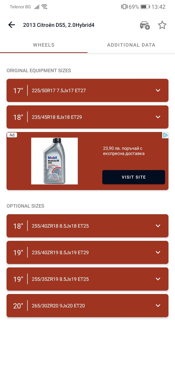

ar80
Posts: 6
Joined: 05 Oct 2021, 16:01
Re: DS5H maximum tire size
Unread post by ar80 »
The dimensions can be seen here
