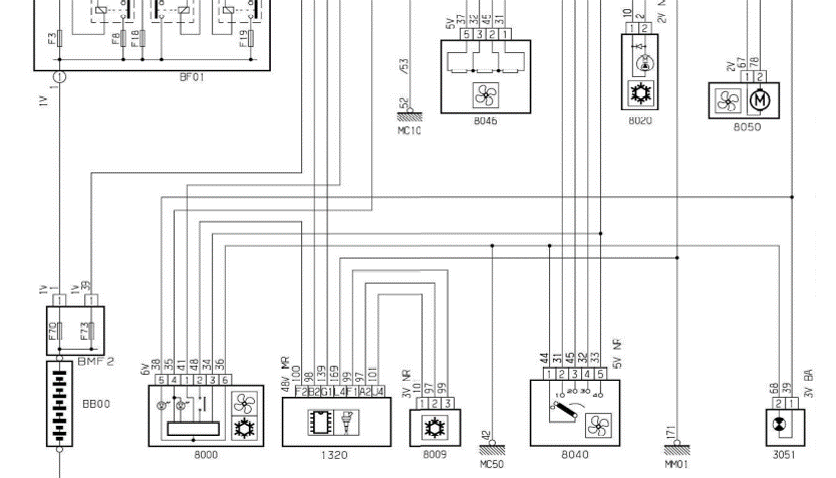

Re: Citroen Relay Aircon stops working on fan speed 3 and 4
From the attached picture (part of wiring diagram) is there anywhere to find out the relevant parts according to the numbers shown? I assume the 8046 is the blower resistor, 8050is the motor, 8040 is the blower switch.
I am not sure what the other parts are
see: https://frenchcarforum.co.uk/wiki/Elect ... ring_Codes
Pull the relevent fuses (one at a time) and check for any signs of corrosion, burning or overheating of the contacts.
