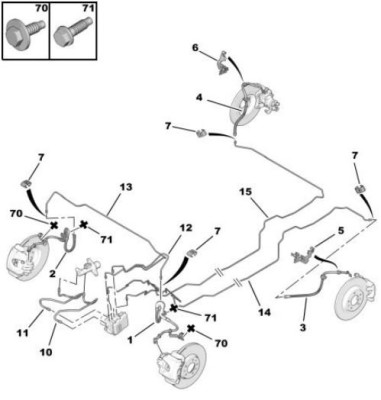

Ok, only the pipes are sold by Citroen as has been mentioned above, but let me know which item number you need from the diagram, and I'll get you the part numbers.

I'm not sure that the bolts are listed on there. All I know is that the garage has told me it's the banjo bolt and copper washers that they need.
I guess looking closer it could be 70 or 71, I'm not entirely sure where they are located on the image though

(70) is Part: 6923H0 (6X100-16) 0.36p each
(71) is part: 6923G6 (8X125-20) £2.08 each

Darn, those aren't the banjo bolts for the hose. Thanks for trying though, I appreciate it

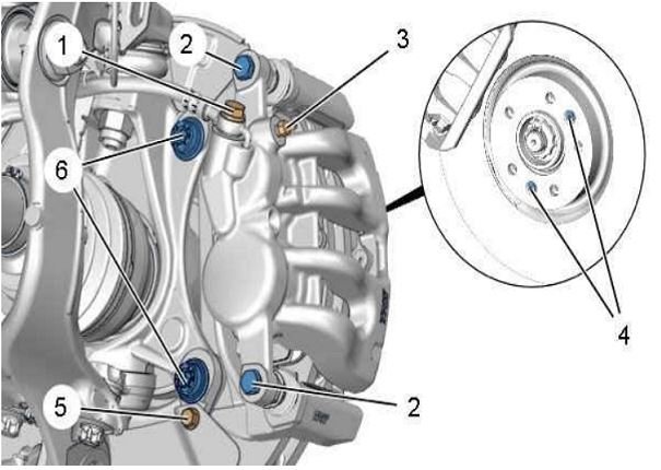

As you have metallic suspension, you will have the TRW Calipers not the Teves. In case it helps here is a picture of the TRW calipers in case they are referring to the specific bolts and their torques:
ReferenceDesignationTightening torque
(1)bolts (Hose on caliper)4 daNm
(2)bolts (Front brake caliper) (*)2,9 daNm
(3)bleed screw(s)1 daNm
(4)bolts (Front brake disc)1 daNm
(5)bolts (Disc protector)1,2 daNm
(6)bolts (Front brake caliper support) (*)11,5 daNm
*) Always to be replaced whenever removed

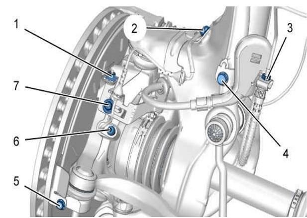

Here is the assembly side for both versions
(1)nut(Disc protector)1,2 daNm
(2)bolts (Wheel sensor harness support / Pivot)1,2 daNm
(3)Union (Hose / Rigid pipe)1,5 daNm
(4)bolts (Brake hose bracket / Pivot)2 daNm
(5)bolts (Front brake disc protector)1,2 daNm
(6)bolts (Front wheel sensor)0,8 daNm
(7)bolts (Brake hose bracket / Wheel hub)1,2 daNm

It does sort of, the bolts I'm looking for are 1 in the first image. I'm just going to call the garage now to get them to double check if the hoses they have came with the bolts or not, because everywhere I'm looking, even the aftermarket hoses seem to come with those bolts
