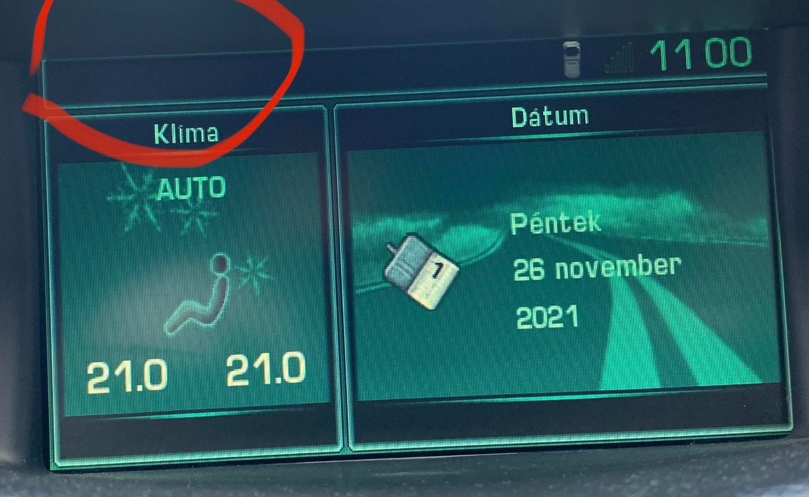

So, from one day to another, the ambient temperature figures disappeared from the top left of the display of the RT3/RT4 unit (I am still confused about the model, but "screenshot" is attached for your reference).

- so it is the display which is missing the figures...but the display itself does not look like damaged or malfunctioning. It looks more like the outside temperature display option has been ticked out in the configuration or something - if there is something like that at all.

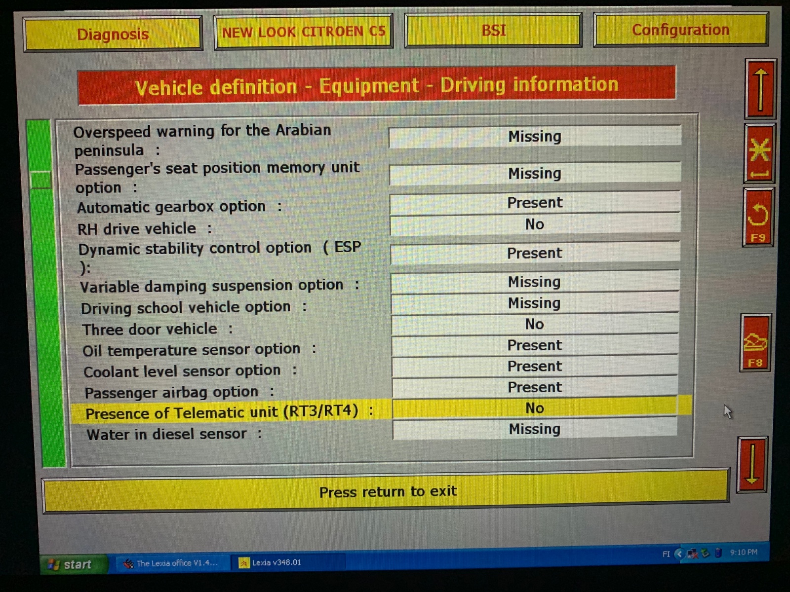

The strange thing is when I start a global test in Lexia, in the listing it shows that the software can not communicate with the Radio and the Multifunction display ECUs.
Then I checked the BSI configuration and there it shows that RT3/RT4 unit is set to not present.
Should I change this to “present” and maybe then I can check the unit configuration as well?

In BSI "Configuration" I set "Presence of telematic unit RT3/RT4" from "No" to "Present" - nothing changed
In BSI "Configuration" I set "Presence of RD4 radio" from "Present" (another weird setting here) to "No" - nothing changed
In BSI "ECUs present" I Set "Telematic" from "Missing" to "Present" - Telematic option appeared under "Global testing"
In Telematic “Configuration" under “Display options” I set "External temperature" from "Inactive" to "Activated" - after hitting “Configure” the system replied “Downloading defective" and unit froze.
Restarted with DARK button, èt voilà! The outside temperature showed up in it’s place!
Strange enough, in the BSI configuration the "Telematic unit RT3/RT4" went back to “No” and "RD4 radio" went back to "Present" by itself….
