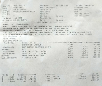

Bit of an update what have been done.
2 weeks waiting in main dealers yard for a timeslot for diagnostics.
1 week waiting for parts.
2 days of works...
And final result costing €1450
2 days of works...

Thanks for the update. That's a good price overall, considering you've had all the faults sorted, a new clutch kit, hydraulic bearing and flywheel as well as a few other bits, plus the programming. At least you know that is sorted hopefully for another 160k KMs.
