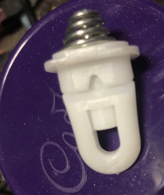

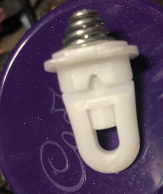

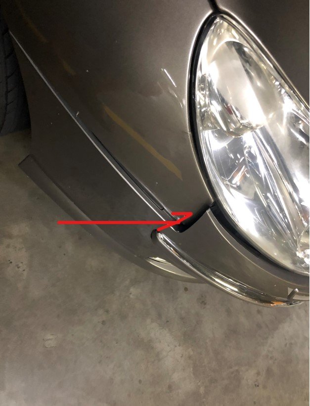

Anyone have any quick tips on how to fix the bumper to the fender as per pics
Seems there is no way to remove the headlight without removing the bumper, which sort of defeats the purpose of the clip
Ive seen a Youtube where you insert a wire hook and spin the clip around but have no idea how to get the clip inside in the first place (or is that why you have to remove the whole bumper) .

Yes, you have to remove the bumper in order to remove the headlight, there are 1 or 2 bolts hidden behind it. The clip is attached to the bumper. It pokes through a hole in the wing in the vertical position and , after removing the inner wing, using a bent rod you turn it through 90 degrees to secure the wing to the bumper. This is if I've remembered correctly.

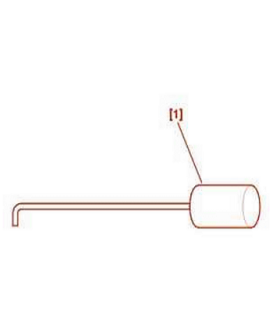

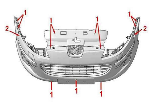

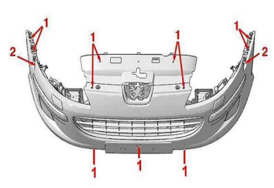

Procedure for bumper removal - prior to replacing headlamps, (you may not need to complete all steps accomplish what you need).
Remove (Partially):
The front right mud-shield
The front left-hand splash-shield
Remove: The number plate.
Remove: The mountings (1).
Release the fixings (2) by a quarter turn on the right-hand side / on the left-hand side (Using the hook tool)
Disconnect: The headlamp wash pipes if fitted.
Close: The headlamp wash pipes if fitted.
Disconnect: The connectors (/) (Front fog lamps).
Disengage the front bumper horizontally towards the front.

managed to do it by only unbolting 4 bolts (eg the 1 and 2 on the driver side) and under the car
The clip clips in but I was a bit rough with the first one and it ended up in a few pieces (one of which is still missing somewhere in the engine / lights area)
Lucky I bought two of them
