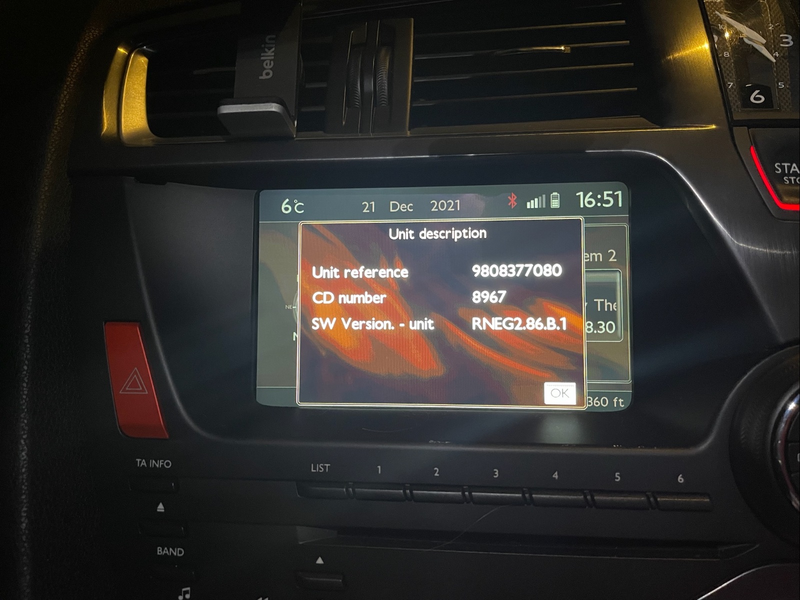

Sorry to hijack but what is the procedure for checking firmware version please? (Also how do I check for faults like I used the be able to on my 3, bulbs etc)
- x 6957
Re: Citroen DS 5 2012 missing define vehicle parameters
Tom: Start car, press SETUP button for about 3 seconds, then select 'radio-telephone diagnosis', then select 'Unit Description' and let me know what it says.
tomjyoutwit
- Posts: 127
- Joined: 17 Nov 2018, 13:11
- x 5
- x 6957
Ok, so you have the latest (and last) version of firmware for this unit.
