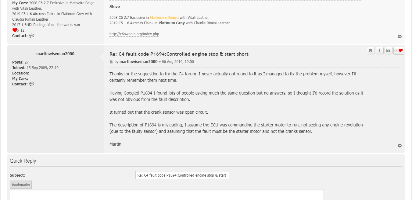

How long does it crank for when you press the button? Elsewhere seems to suggest that P1694 is associated with the crank sensor, although it talks about stop start system. Put the Diagbox back on, then see what the engine speed is when cranking and what the fuel pressure is doing.

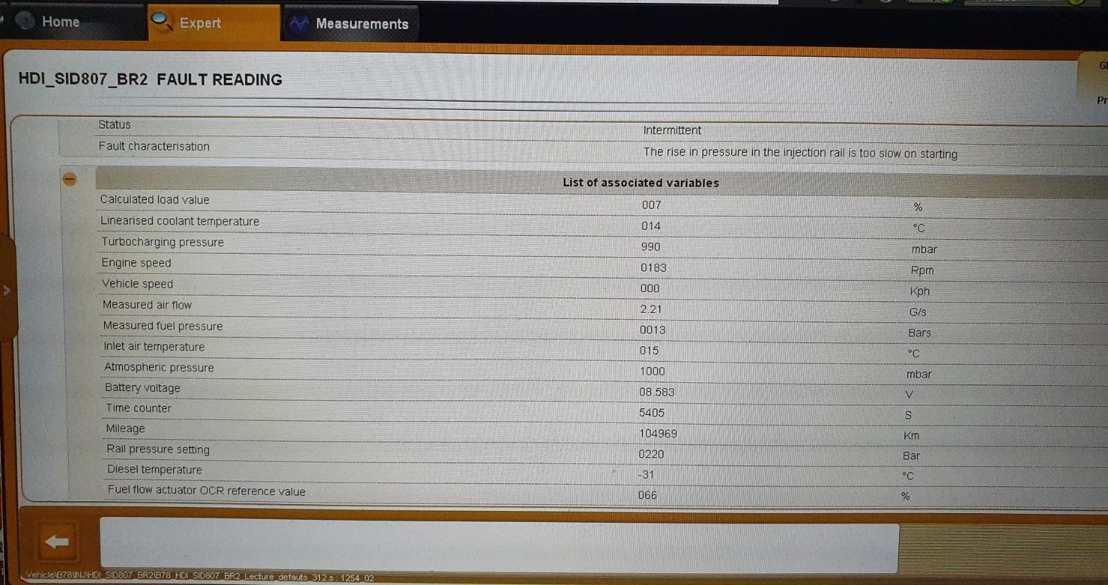

From the P2291 error it has the following values stored:
Engine Speed: 0183 rpm
Rail Pressure setting: 0220
Measured Fuel Pressure: 0013

This fault code specifically seems to be about starting a warm engine (as in where it has cut out and when you are re-starting the engine). Hard to say with your other previous issues, but looking at the list of suspects above, is would seem to indicate some sort of fuel starvation issue if I had to take a punt.
The rail pressure at cranking should be about 200 bar. When running:
So that pressure of 13 Bar is far too low if that reading is at cranking.
How long since the garage did this work and did they bleed the system correctly when they changed the fuel filter?
