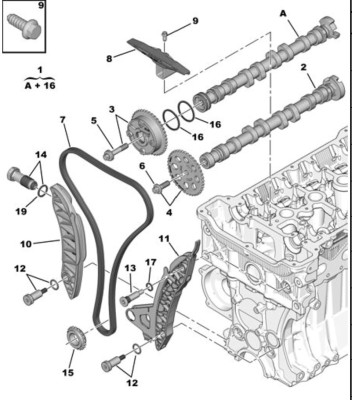

This is the timing tensioner for that VIN (you missed out an L and 3 from the VIN)
Part: 1675941180 is the replacement and costs £47 UK inc. VAT.
Item (14) below:
Item (14) below:

Don, the engine code would be digits 6-8 on the VIN- in the case of my 2013 DS5 THP155 it is 5FV. I have bought cam chain tensioners from EAI in Melbourne for about $90 and for $16 from China. I could not discern any obvious differences and they both had the holes in the top indicative of revised versions. Both crunched when you compressed them, which I found disturbing as I would have expected the action to be smooth, as it was on some that I have removed from vehicles. They worked ok however.
I am astonished that the failure your friend experienced was caused by the tensioner body breaking- after all the tensioner is merely pressing against the rear of the plastic chain guide. It will be interesting to see how the valve timing looks - it would be a bonus if you did not have to undo the torque to yield bolts on the crankshaft/camshafts. Especially the crankshaft as making sure there is no oil on the faces of the two chain sprockets (timing chain and oil pump behind it) and the end of the crankshaft is demanding.
