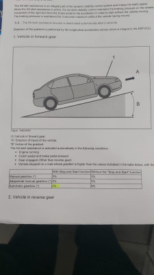

I've very rarely used the handbrake when driving a stick in the old days; why start now on a modern car? And using the handbrake is not always an option, for example in stop and go traffic.
hill assist spec
hill assist spec
Posts: 42019
x 6955
Re: model 2008 won't activate hill start assist light slope
Well, I'm just saying that's part of the reason for a handbrake and you shouldn't rely on the automatic system as any fault with the ESP system disables it anyway.
Maybe your slope was less than the 3-4% shown.

The slopes were the problem shows up are definitively more than 3%. And according to Peugeot, the system will disable itself if a fault is detected, so I should be able to trust it. And the less experienced drivers in my family should also be able to trust it. By the way, it's not that the hill assist never works, it's just unpredictable. And that's not how cars are supposed to be, at least most of the time.
