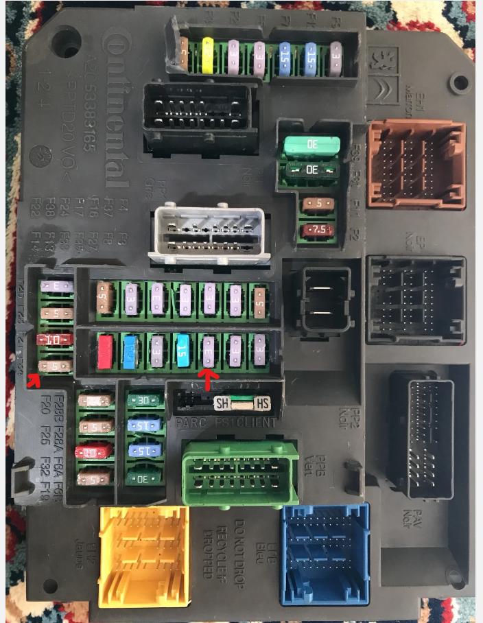

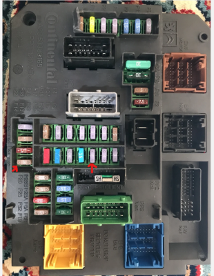

First I was using a fuse adapter and installed my USB cable to the fuse on the left of F8 (3A - F27), then I moved it to the fuse with the arrow (5A - F34) as I was sure it was that one that messed things up. Even after I have unplugged my battery and uninstalled the adapter am still getting all kinds of error. Does anyone have some tips for me so I dont have to go to my dealer and pay 150 euros just for diagnostic?

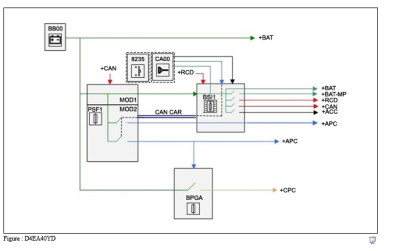

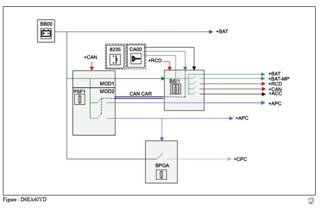

Am suspecting it has something to do with the permanent power (BAT+ / CPC+) supply as It looks like the BSI isn't able to stay alive after I turn my car off, I have installed thermoconnect (turning off and on the webasto heater with my phone) and it only work when I have unlocked the car / started it and before my failure it was on/powered all the time. (Its connected straight into the BSI / EH2 for power). I have checked the BPGA and it looks okey and giving out power, havent yet been able to take a closer look at the BSI itself

Check all the fuses not just the ones you were working on. Remember under bonnet ones too.
