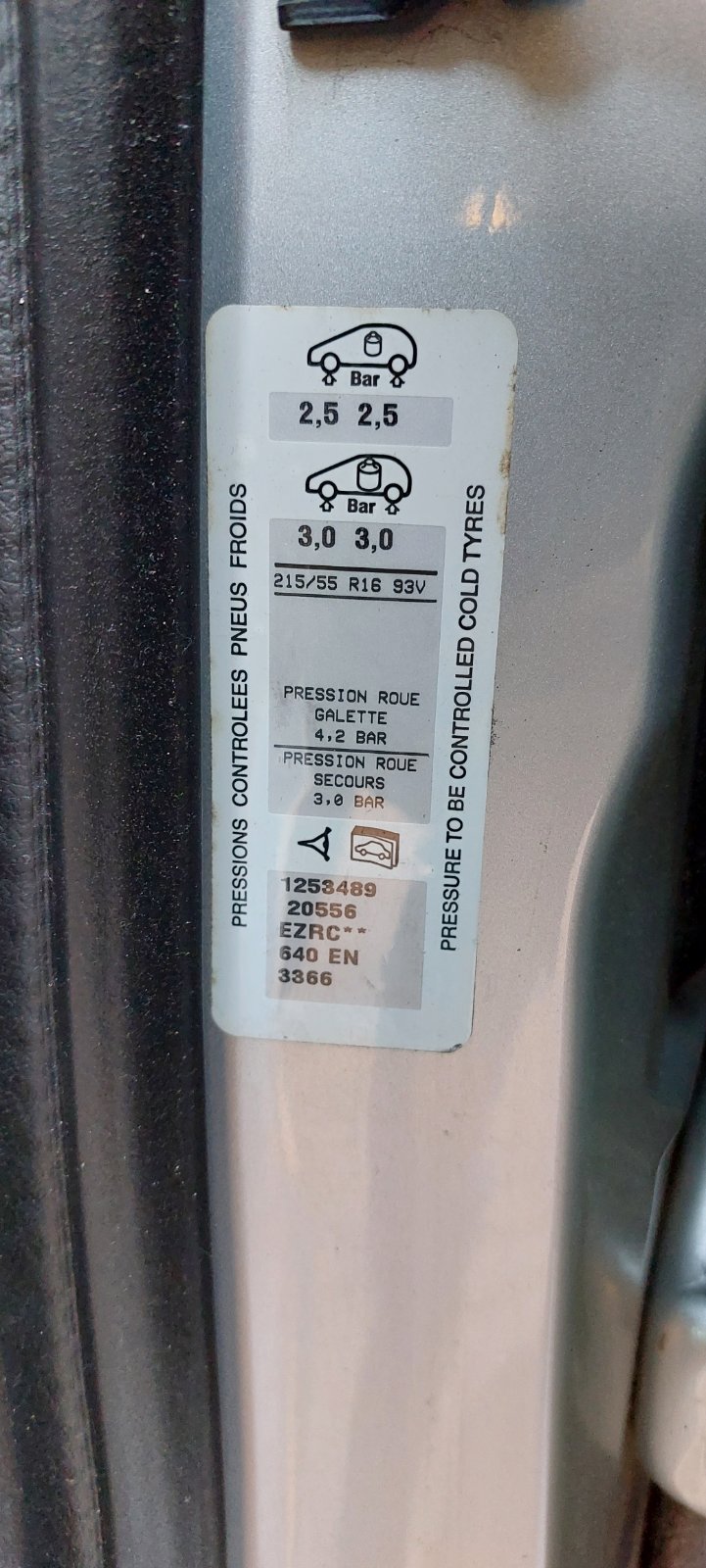

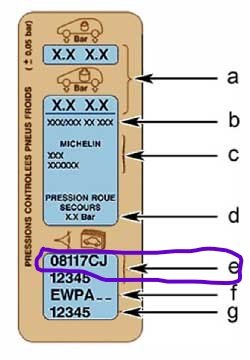

Yes, what is your RP number? its shown on the tyre pressure sticker.
It will most likely be Eolys Powerflex but the car could have been built long before it was registered.

I'll have a look in the morning and get back to you.
Andy88
Posts: 18
Joined: 28 Aug 2020, 16:50
Re: Diesel Particulate Additive levels too low
Unread post by Andy88 »
There's the numbers mate

You need Eolys Powerflex
