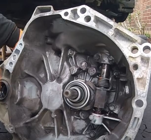

I'm in the middle of replacing the clutch on out 2013 1.0l C1, and have come across a broken spring.
It sits next to the clutch release fork on the same spindle, and as far as I can see all it does is tension the fork against the splines.
Here's a picture of it from a YouTube video - just above the release fork:
I can't find a replacement anywhere - being Saturday none of the main dealers are open and a google search doesn't come up with anything for the C1.
I can't even find any parts diagrams to find the part number.
Obviously I'll have to wait until next week, when the Citroen main dealers open, as it looks like no-one else stocks this part! Unless anyone can point me in the right direction?

Cant imagine you will get this anywhere apart from a Citroen/Peugeot (or Toyota) dealer.
Part no should be 1607880180 although the Toyota number will likely be different.
This is a superceded number suggesting it has been modified, the original number was 211920.
EDIT: A quick google search comes up with > https://peugeotcitroendsparts.com/peuge ... 607880180/
