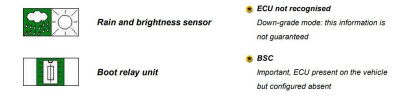

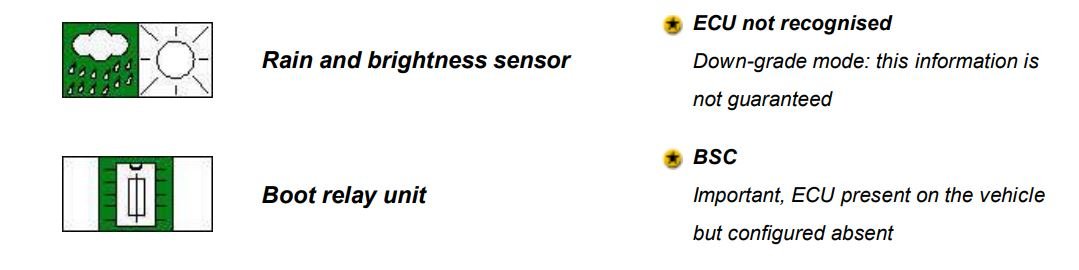

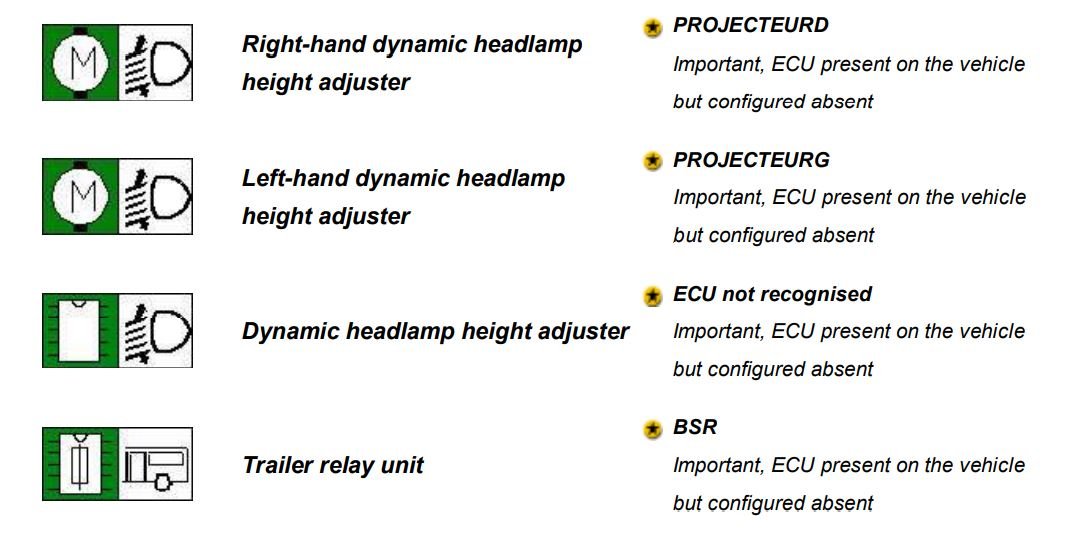

Having run Diag on the toy, can I ask what these "error" messages" mean
Important, ECU present on the vehicle but configured absent
Does it mean the specific ECU is physically present but not correctly enabled ?
I also get the rain sensor saying downgrade mode : this information is not guaranteed - any hints ?

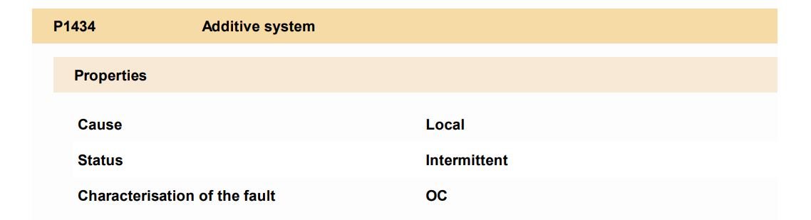

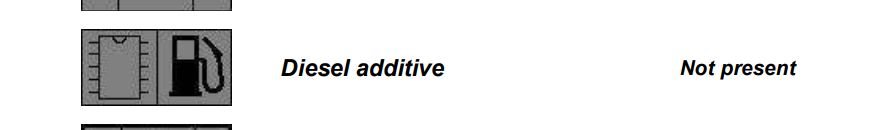

Finally, I assume "diesel additive not present means no ad blue or EOLYS but the Engine ECU throws up a P1434 additive system error code ?

Be very cautious about changing anything here, some systems are designed to be configured a certain way with default values. Take a screenshot of anything before you make changes, and have a read here as some things may not mean what you think they do.

The Diesel Additive greyed out on this model is likely indicating that the additive function has now been incorporated into the engine ECU, so they may have done away with the separate additive ECU that could of been fitted on earlier models. Ignore it.
I have limited info on this engine ECU, but it may relate to an open circuit on the additive system - specifically the pump, so might be something to check around there.
