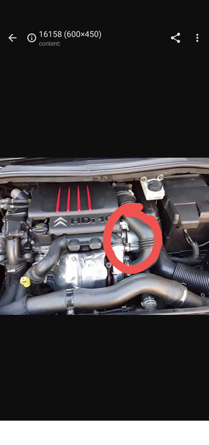

This is not my engine, but the red circle shows where the fuel pump is. It's mostly hidden by the plastic air duct things. The filter is behind that.
It has had a fuel filter change with no change to the symptoms.

Ah, that's the vacuum pump...no idea why cooling that would affect starting! The engine earth is under there somewhere on top of the gearbox... maybe, just maybe, it is a bit iffy and the water runs down onto it and makes enough of a connection to get the starter speed up. Does it sound different cranking when you've cooled it?

What you poured with water is a vacuum pump. On that occasion, you are actually cooling the starter on the gearbox. Check the speed at cold start and at warm start with the help of diagnostics.
