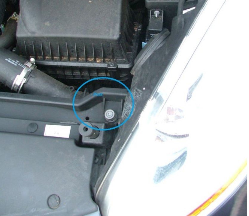

As the title. Just wondering if any extra precautions have to be taken when jump starting these batteries? I have an automatic c4 picasso 2016 bluehdi.

Yes you can no problem, just don't connect directly to the negative terminal of the battery (not that you can probably get near it on this car). use the designated earth point shown below.
