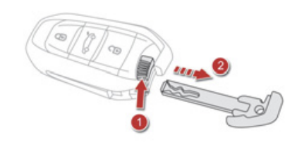

Just use the key to open the door. The emergency key is located inside the fob. It pulls out: Move the latch (1) across whilst you pull the key (2) out.
Then turn towards the FRONT of the vehicle to UNLOCK.
