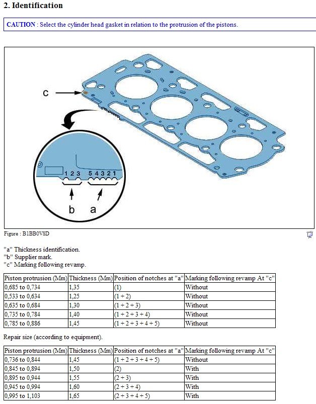

There are several thicknesses depending how many notches on the gasket.
The gasket is selected depending on piston protrusion.

Well, i am from Poland and i bought gasket seal for that engine and they said is just one for that engine no more just one. Bassacliy we have problem with some noises coming from engine and we trying everything but i think my dad need to take all engine out again because we cant find a problem, we was checking for injectors i mean testing they fine smae with fuel pressure on computer it was perfect.
