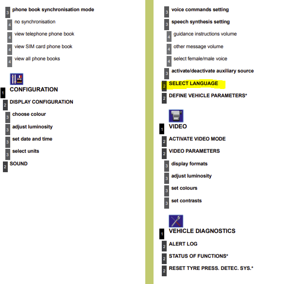

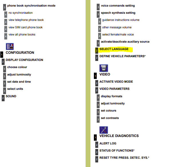

Do you have the map for the menu? I’d like to change the language first to English, it’s now French.
There are four different colour wires. What might each of them do? Maybe the order should be something else
- x 6954
Re: RT4 -> RT5 navigator
You'll need to press the main menu to get the 'wheel' and select the icon with flags on it. In this menu, look for the language option:
But be aware I have heard other members saying the language option is not there on some systems. This means it needs changing at the ECU level.
