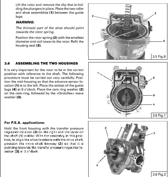

Have problem with correct rotor placement in lucas epic 2.1td
Im not sure its directed correctly.
Theres is on 2 clock
but in this vid, guy placed it on 10 clock
im lost #-o

Here's a part of the WM, if you want the rest PM me with your email, it's quite a large file.
Click on the image to enlarge it.

Thank you, it help a lot
