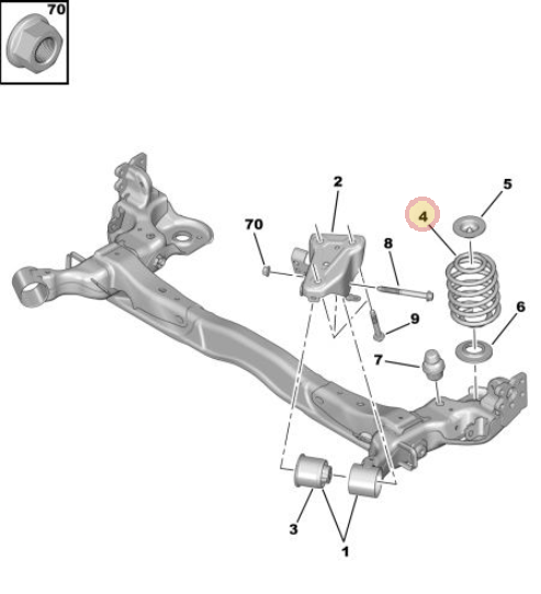

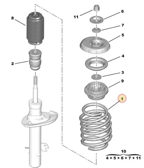

Ok, the front spring is part number: 5002YF, marked 1 Blue, 1 Yellow and 2 White bands. £40.07 each. The top nut must always be renewed (item 11), part: 503615, price £4.21.

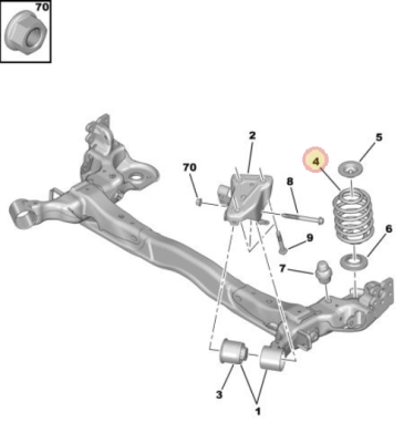

The Rear Spring is part: 5102CT, £113.90 each.

I prefer Kilen/Lesjöfors springs, but most "premium" brands schould suffice.
I always recommend renewing the strut bearing too (no 4 in the first picture), they can be a cause for spring failure.
