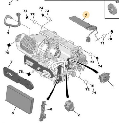

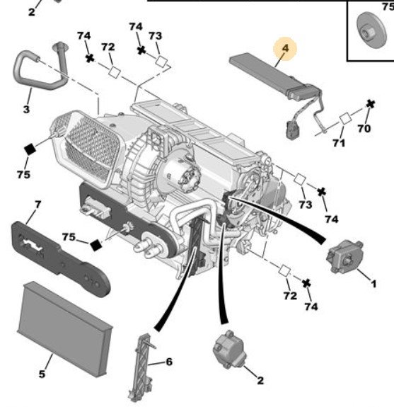

Some diesel models have an additional diesel fired heater but don think it was available on mk2 C5's in the UK, I've never seen one anyway. this may be what the handbook is referring to.
You find them on UK C8's, synergies & they were an option on some Xantia estates.
What your C5 does have though is an electrical element in the heater box to help get heat faster however even if this wasnt working it should eventually still get warm.
I'd be looking a the cooling system first. Coolant level ok? Are the heater matrix & radiator pipes getting warm?
