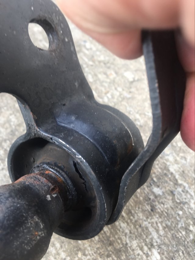

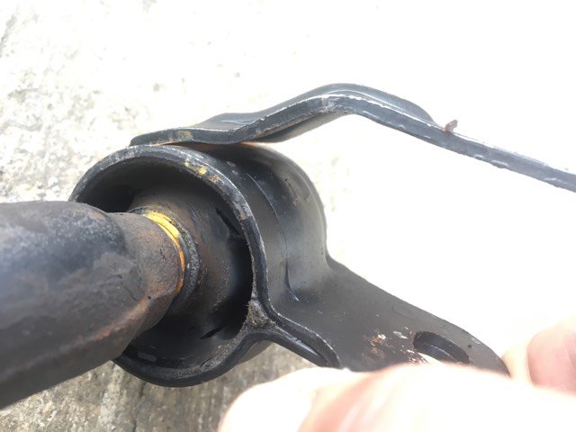

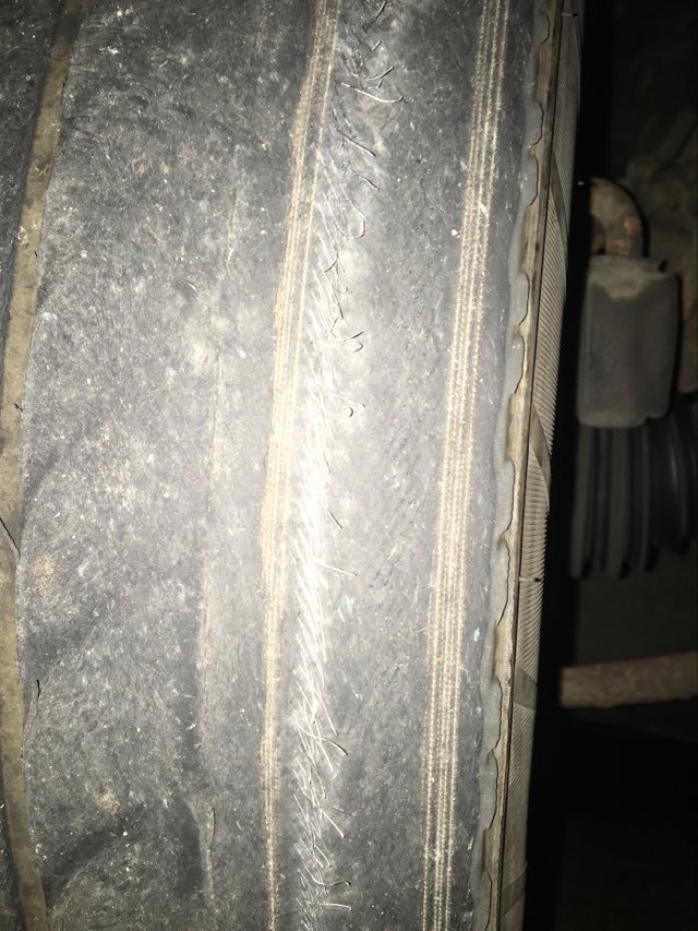

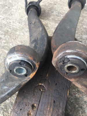

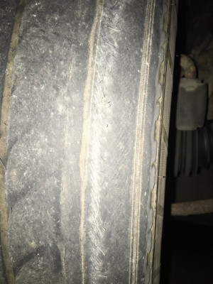

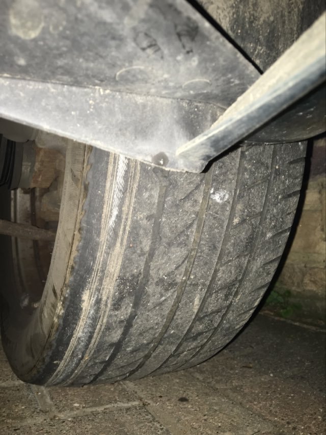

I bought some bushes off e-bay they seemed OK on fitting and passed MoT on offside, within a couple of weeks I fitted nearside as tester had said it was on the way out, but only 1,500 miles later they are both shot ....
I have changed these myself before and got 3 years out of similar ones off ebay.
Seller has said he will refund on return/inspection but no compensation for time/hassle/tyres ruined as the warranty only applies to professional mechanics :roll:
Plus I will probably destroy any 'evidence' when I remove the bushes :oops:

Skulls tyre OSF
Skulls tyre OSF
I have a video of the slackness in situ but AVI is not recognised when I tried to load on here. Got iphone video mp4 but again not recognised mp4 file.
Skulls tyre NSF
Skulls tyre NSF
Skull's bushes
Skull's bushes
Skull's bushes
Skull's bushes
Skull's bushes
Skull's bushes
