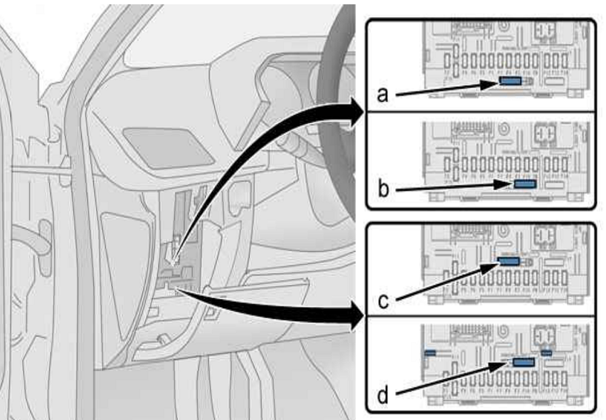

One last thing to check that I've seen time and again is the SHUNT fuse.
Make sure the Shunt fuse is in Customer Mode and not PARK / PARC position - this cuts off some electrical draining functions when the vehicle is being stored. Check your manual under the fuses to see the correct position it should be in, but for the 3008 it can be either above or below the bottom row of fuses as shown below depending on the BSI fitted to the 3008:
If it is in position 'a' or 'c' (shunted to the left) it is in Park mode and incorrect.
If it is in 'b' or 'd', (shunted to the right) then it is in Customer Position and correct.
So if it is correctly shunted to the right, I would put some pressure on the fuse to make sure it is well-seated in the fuse socket.
Also double check that F7 fuse - don't rely on a visual check, it should be a 5 Amp fuse - unless of course any one or the previous lights I mentioned are working, in which case it is not the fuse.
I can't see the battery disconnection doing anything to be honest - are the rear ceiling lights working? If they are then it's not your fuse.

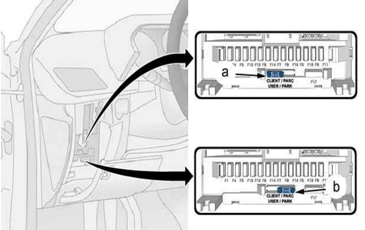

Yes, for your 207:
"a" Customer configuration.
"b" Transit configuration.
- Switch off the ignition
- Wait 2 minutes for the BSI to switch to standby
- Remove the flap to access the fuses
- Remove the shunt from the park position "b"
- Place the shunt in the customer position "a"
- Press the shunt further in, to force it fully into its housing
- Refit the fuse access flap
- Check that the fuse access flap is flush
