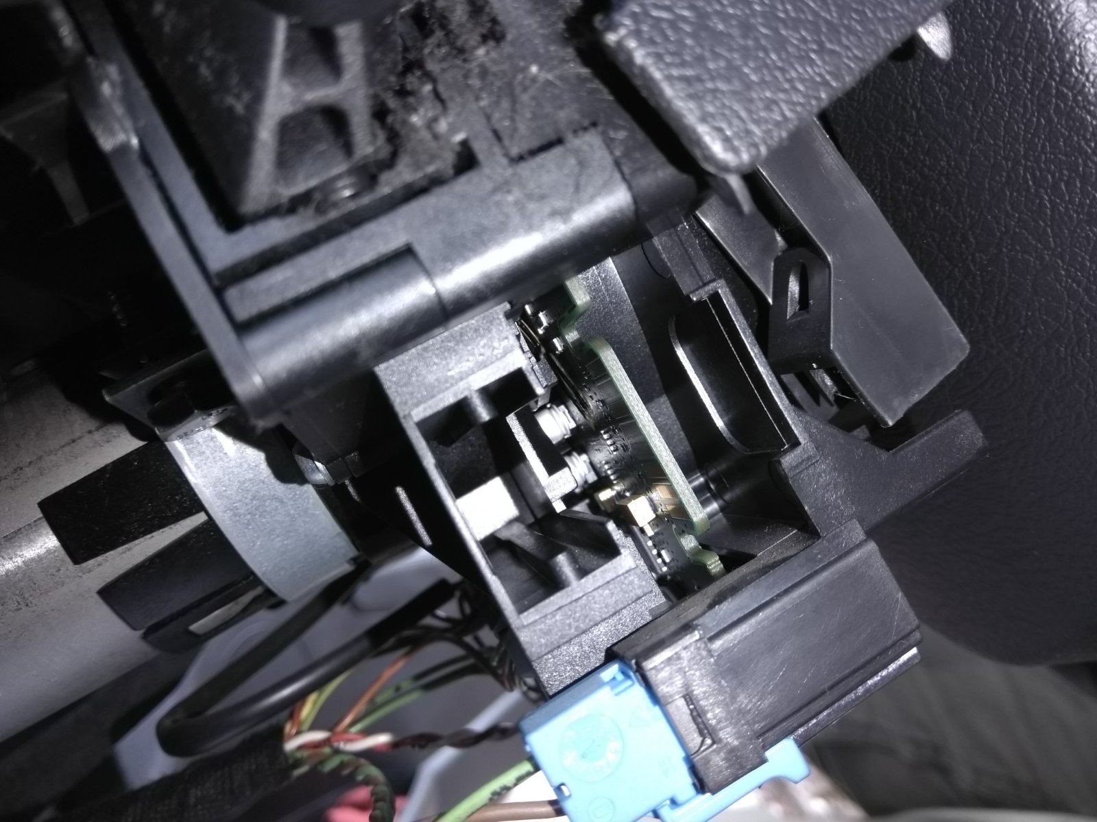

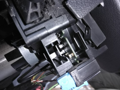

ok, I am not sure on the switches as I cant see under there

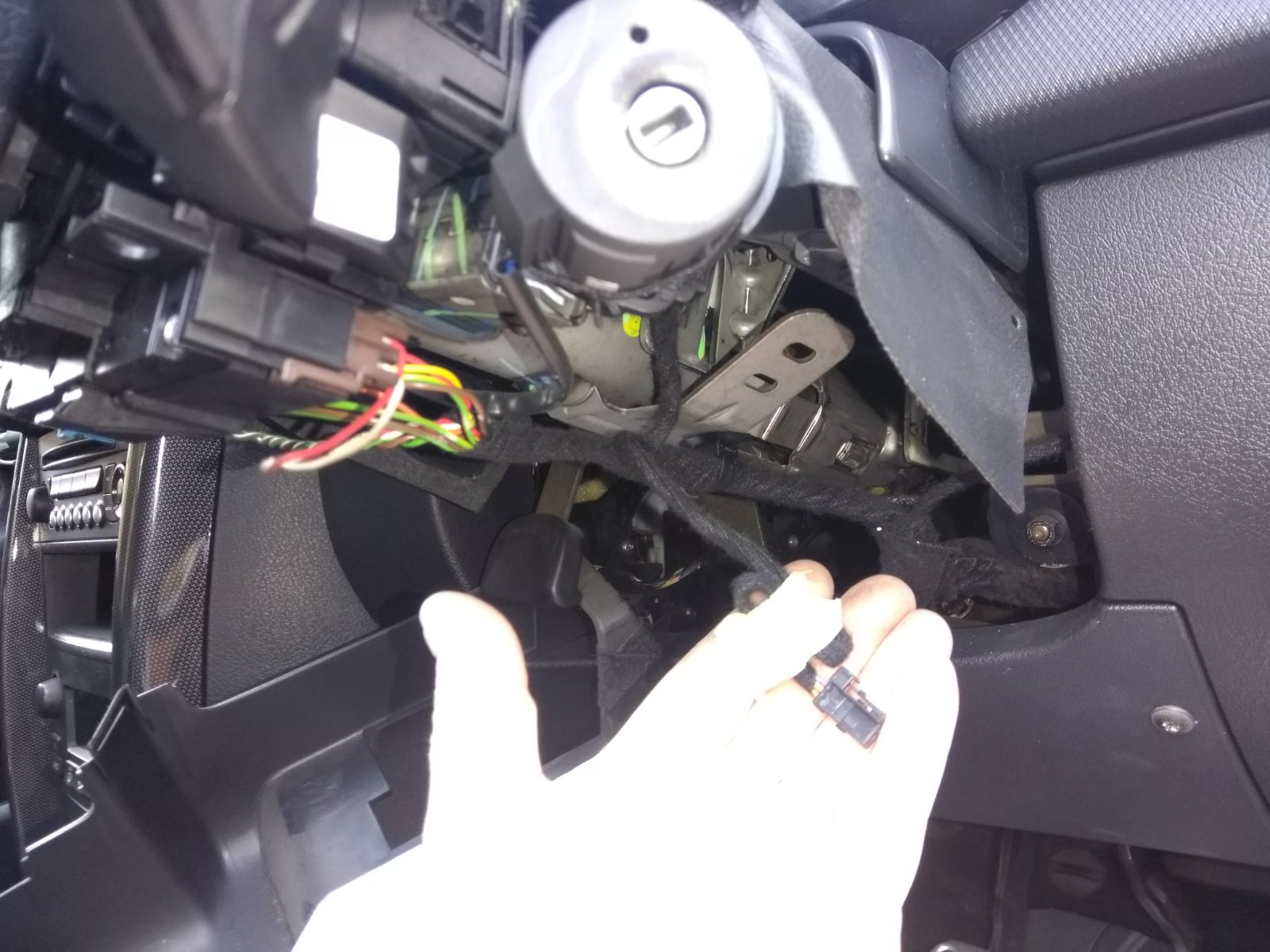

the gap is in the column where the stalk pushes in to the electrics, I have just had a look - I also found a cable that isnt plugged in - any idea where it should go, what its for?

I have added cruise control to a 1.6 C2 and a 1.3 C3 (2004 and 2003 respectively). Peugeot's of that era should be much the same. You did not say what year your car is (apologies if it's apparent, not that familiar with Peugeot's).
Not familiar with diesels but the engine must have a fly-by-wire throttle body. What the hell AM I familiar with?
The cruise control is "multiplexed" (not really multiplexing) from the COM2000 to the BSI and then multiplexed to the engine ECU. The engine ECU is directly connected to the clutch switch and the secondary stop light switch contacts. There are 2 sets of contacts in the brake switch. The primary set are used by the BSI for the brake lights.
There are 2 types of these COM2000 units for PSA cars manufactured between 2002 and 2009. One type is for pre 2005 CAN-VAN systems and the other post 2005 CAN-CAN vehicles. The change over was September 2005...I think.
On the pre2005 COMs the cruise control buttons are on the steering wheel and the cruise control switch logic goes through the "clock spring" of the COMs unit.
On the post 2005 COMs the cruise controls are on a pod that plugs into the side of the COMs unit.
Both types have that slot in the side. For the pre2005 units that's for the "flappy paddles" and the post 2005 units it's for the cruise control and radio control pods.
I am familiar with the pre2005 COMs but not the post 2005 units. The pre 2005 COMs have 2 different circuit boards covering about 5 different variants!! I dare say it's similar for the post2005 units.
So you are going to have to make sure you have the correct COMs unit (that is cruise control ready) for your car.
If your car is a manual, you will need to check if you have the clutch switch fitted. The C3 I fitted cruise control to was a PRND auto and it had a clutch switch fitted!!! TRUE! The clutch switch was NOT necessary. When I activated it with the LEXIA (because...why not?) the system whinged that there was something wrong with the switch as it's state had not changed in X number of drive cycles!? So I disabled it. If your car is a manual the BSI and/or engine ECU might go looking for it. The C2 was a sensodrive...again no clutch peddle so I'm not sure about manuals.
The cable and connector in the photo will be for the flappy paddles used on the sensodrive gearbox. Not all of the devices (switches ETC) go through the multiplexing port on the COMs unit. The air bags, flappy paddles, ESP, for example have separate connectors on the back of the COMs unit and go directly to their respective ECUs.

Just noticed the radio in the second photo. Its a CAN radio so your car has an all CAN network and therefor uses the second type of COMs unit with the plug in pod type cruise controller.
Give-me-a-break might be able to tell you the part number(s) of the required COMs unit?
