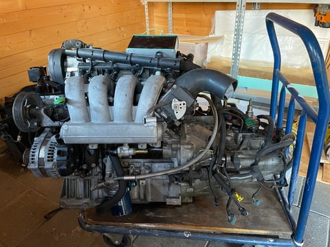

Re: 206 180 turbo - Gearbox ML6C
As you already found out yourself, the 20MB06 will fit. I have one on my EW10J4S turbo that is going into my 306 Estate. I don’t know if the 206 (or your aftermarket ECU) requires a VSS signal. But that will need some attention (see: https://www.406oc.co.uk/viewtopic.php?f ... ed+gearbox).

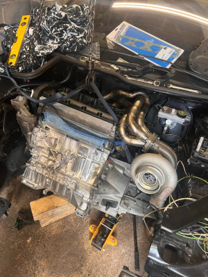

Sorry for the bump, a lot has been going on but now im back to this project. So my engine is now fully built with the forged parts and its at the stage where i can bolt up this gearbox. The 180 clutch and flywheel all fit into the gearbox which makes things nice and easy.
i have ordered a set of 406 2.2 driveshafts in the hope that i can mix and match the parts with the 180 shafts. i think the 406 shafts have a beefy inner spline which ill need for the gearbox. if all goes to plan i could have this engine test fitted in the next couple of weeks. then its onto sorting the gear cables out.

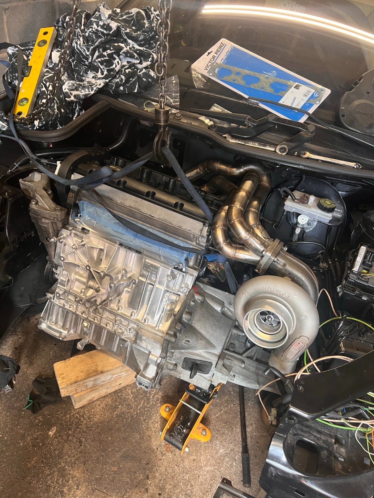

Back again with abit more progress, Engine and box are in temporarily, the box does fit in nicely but i had to removed the diff brace and cut the studs down so they dont hit the subframe. The orginal 180 box mount doesnt really fit but i have modified it with some plate and the engine is now sitting on its own mounts.
Other parts needed will be a 6 speed gear selector and cables from a car with the ml6c manual in it, diesel or petrol will work. You need this for the reverse lock out pin, cables will need extending which is easily done.
Haven't had time to play with the shafts yet but when i do i will post back, i might even do a progress thread in case anyone ever ends up doing the same.
