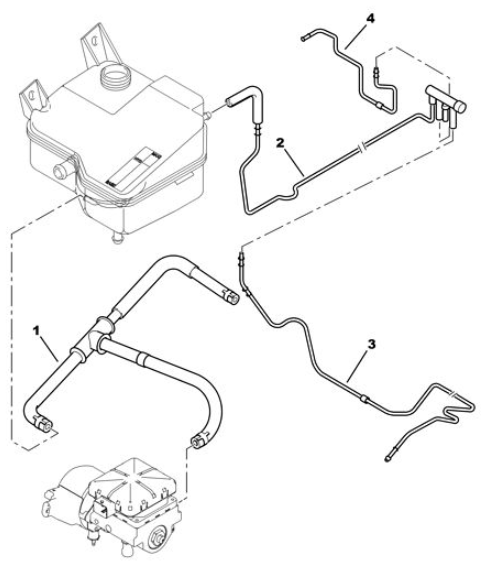

Here are the return pipes for the the rear suspension (1) & (2)

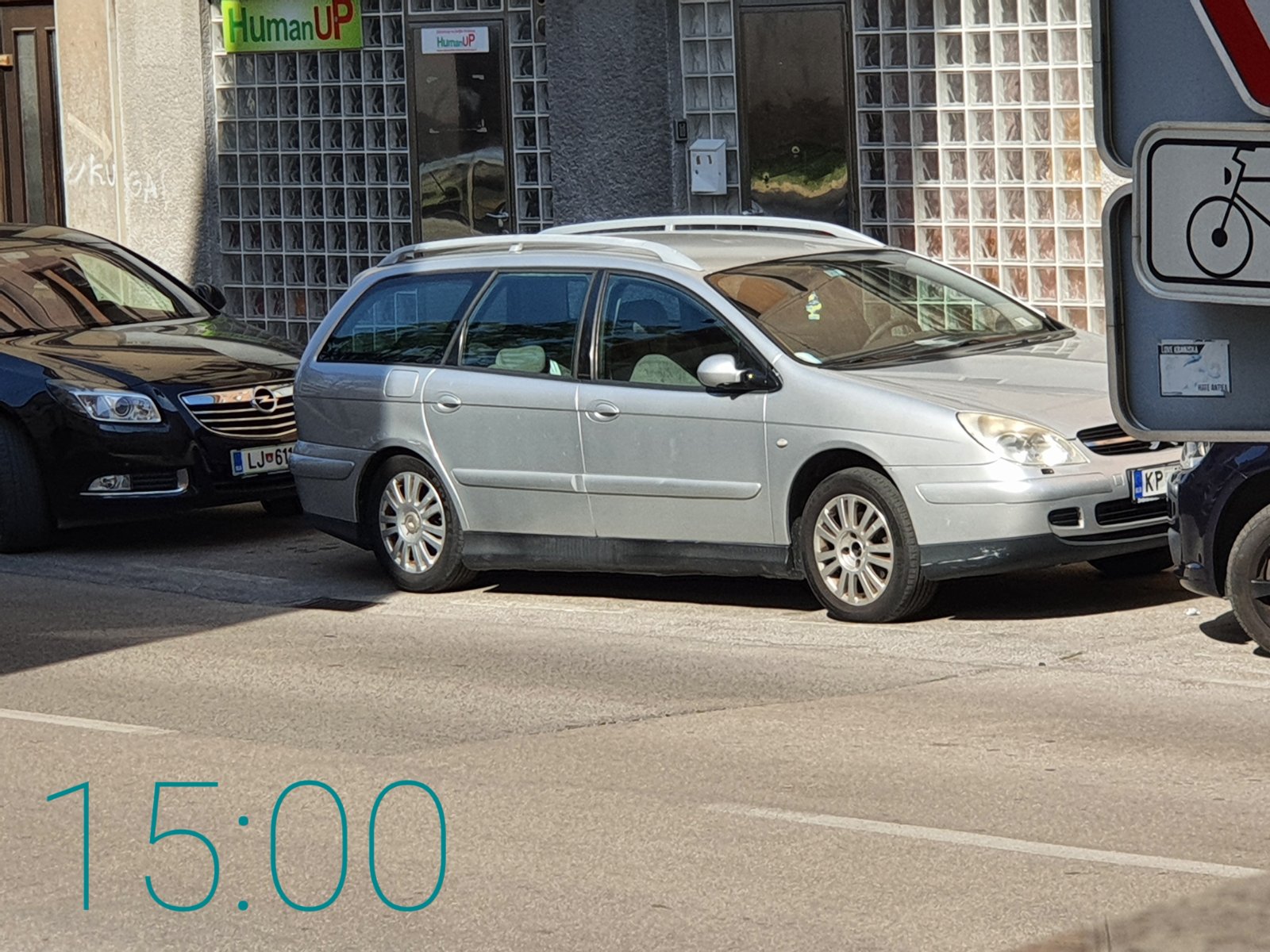

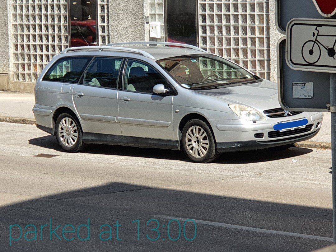

I have also attached 2 pictures, one when parked and one after 2 hours that shows the rear end dropping slowly.
Sadly the strut ends of the return pipes are much too short to be reattached as they would just pop off when the suspension extends and are also very easy to split. Can you give me some part numbers for the correct flexible return pipes from the strut end on the front?

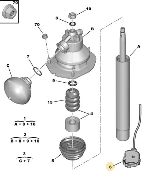

Ok, so the leak-back hose is item (6) and needs the adjusting collar. These are still available.
Item (6) is part 95050399 £21.34
The Adjustment Collar is part: 96127591 £5.44
These include UK VAT @ 20%, so whatever the equivalent is in your Country.

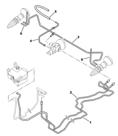

Below are the front return pipes. If it's any of these, the only one currently still available is item (4), the hydraulic Oil Back Harness for the RIGHT side. The Left side is no longer available from Citroen.
Item (4) below is part: 5270QL and is £36.83
