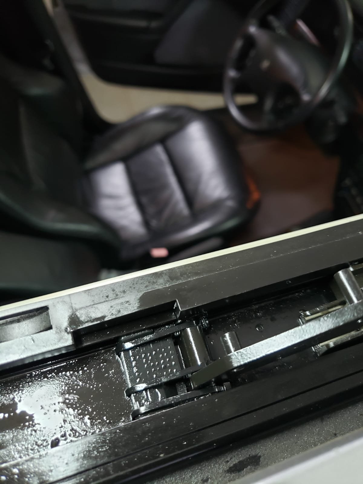

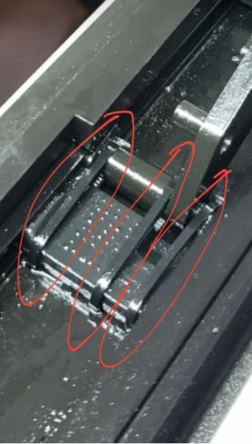

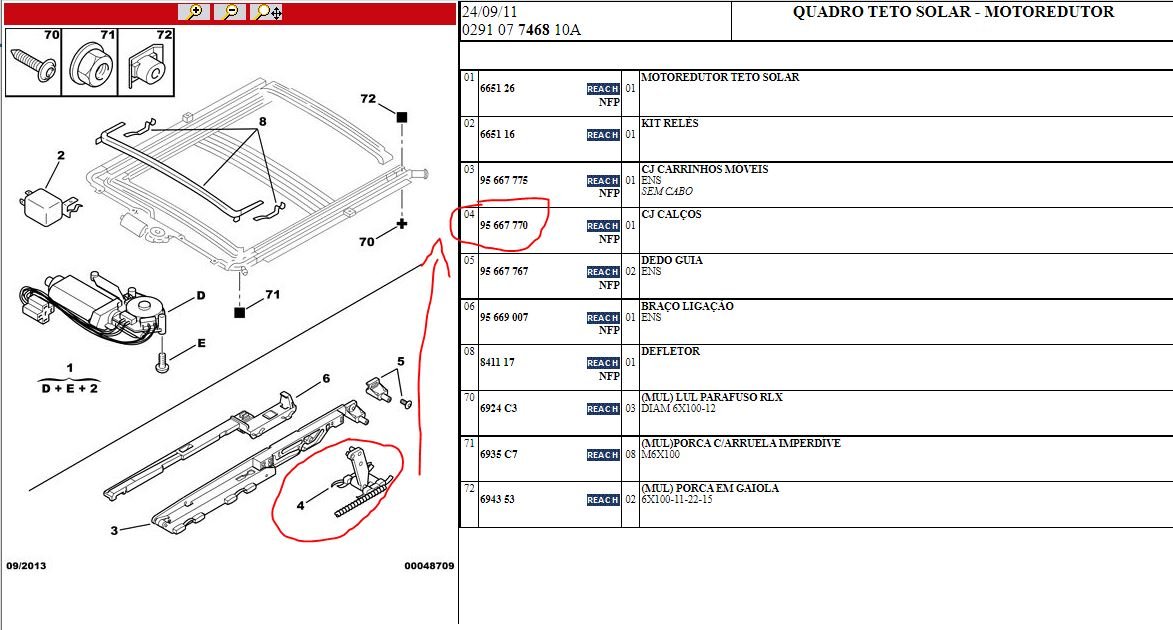

My roof was locked and sliding a little out of alignment. In the first few centimeters it already stopped sliding. After a quick look, i´ve found that the following part where broken
And, with a little help of some zip ties....
Everything where just fine... It was working absolutely perfect and smooth. Here´s a video:

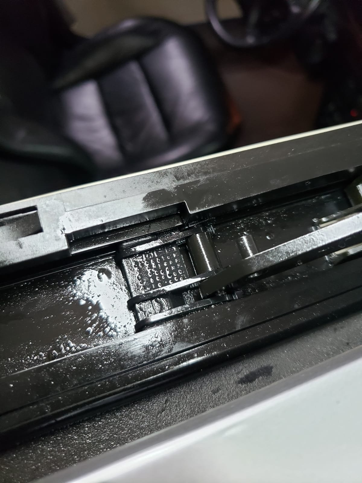

Now, after 3 or 4 weeks (2 of these kept in the garage), I went to open the sunroof and it found itself stucked.
I tried using the emergency crank. No success.... I couldn't turn in any direction. After a few attempts (crank + sunroof button) I managed to get it back up and running.
But now it's working making this weird sound. It sounds like it's "pulsing". Watch the video:

1) It sounds like either something is getting caught only on the opening phase / opening direction - have you checked those cable ties are in place and nothing has come loose and got jammed? Something could be sticking and causing the motor to strain intermittently.
2) Maybe when it got stuck and you forced it open, it has upset the motor gearing? Can't say for sure but it sounds like it is skipping or struggling intermittently on the opening cycle.
