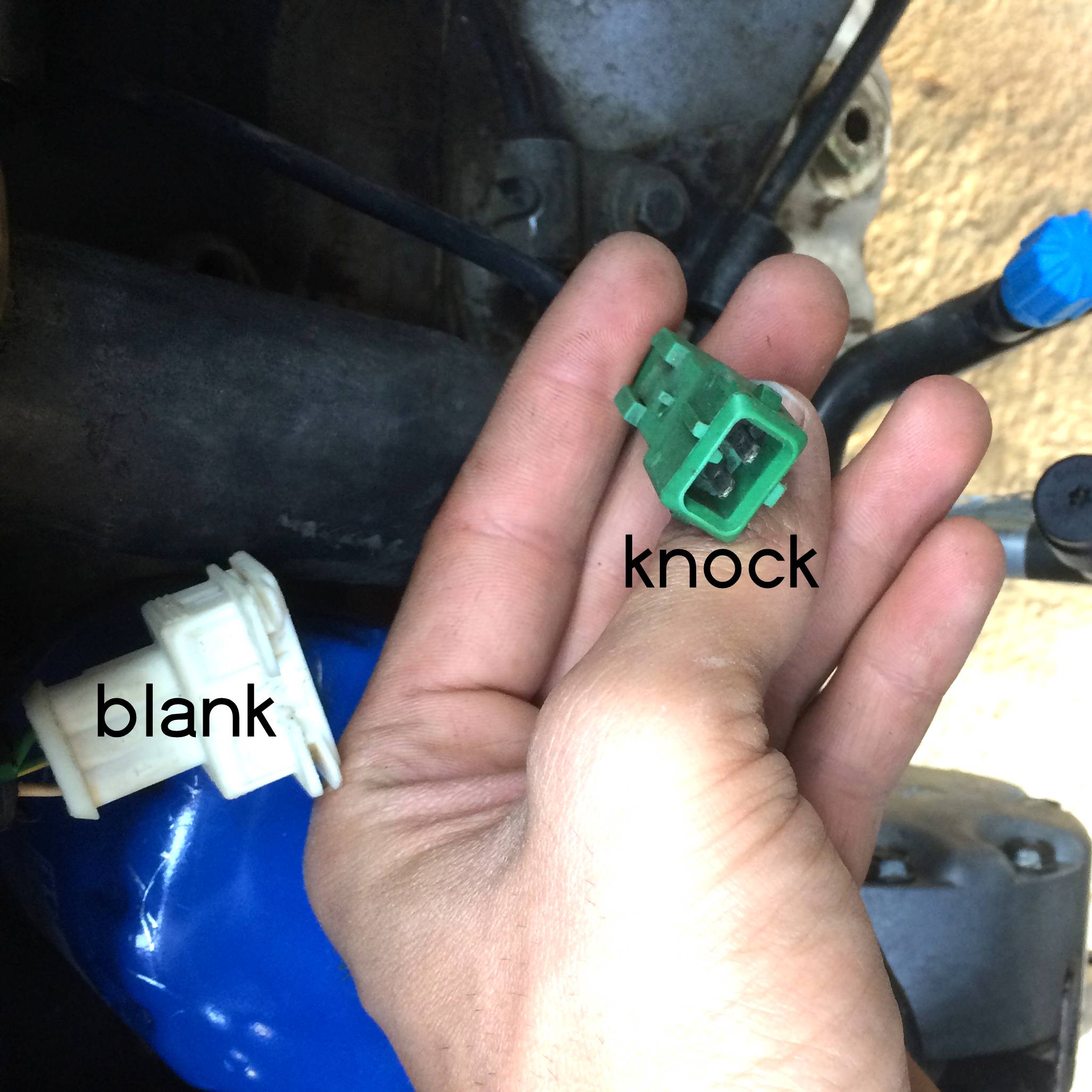

hi there.
the engine is xu10j4r with bosch mp5.2 ecu

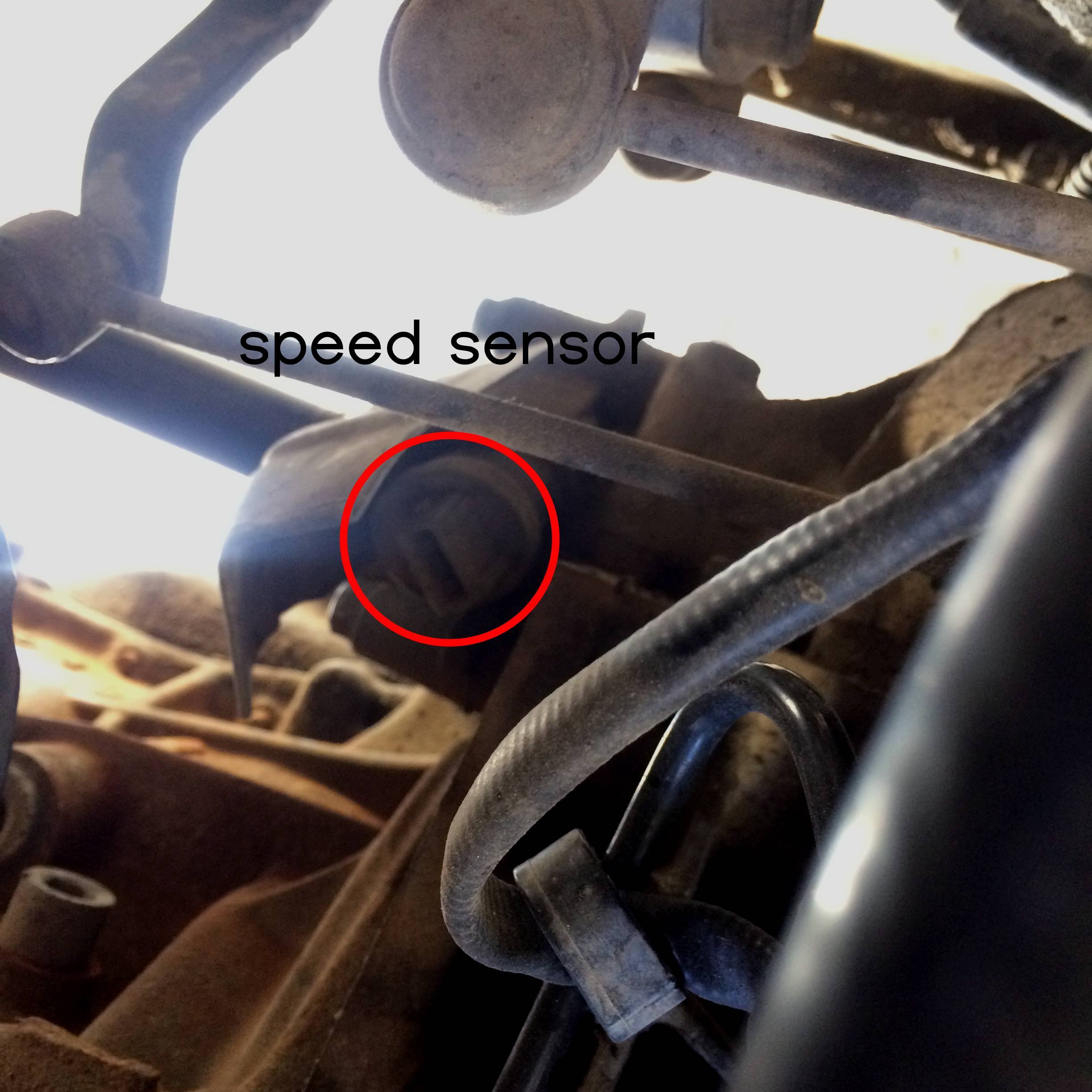

i was checking speed sensor and then i saw that there isn't any connector for it!
is it not used?!!
also there isn't any connector for knock sensor!!
and there is a white 3 pin connector that comes from electric harness, not used too!!
is it normal?!!

Ive never seen either of these unused on a Xantia, as the Xantia is not multiplexed is wont use the ABS for speed info so there must have been a connector for it. The road speed sensor should have a 3 pin white connector, just like the one you have listed as blank?? Does it reach the sensor?
Same with the knock sensor, i have never seen one fitted but not plugged in.
Has the engine or gearbox been removed recently by any chance?

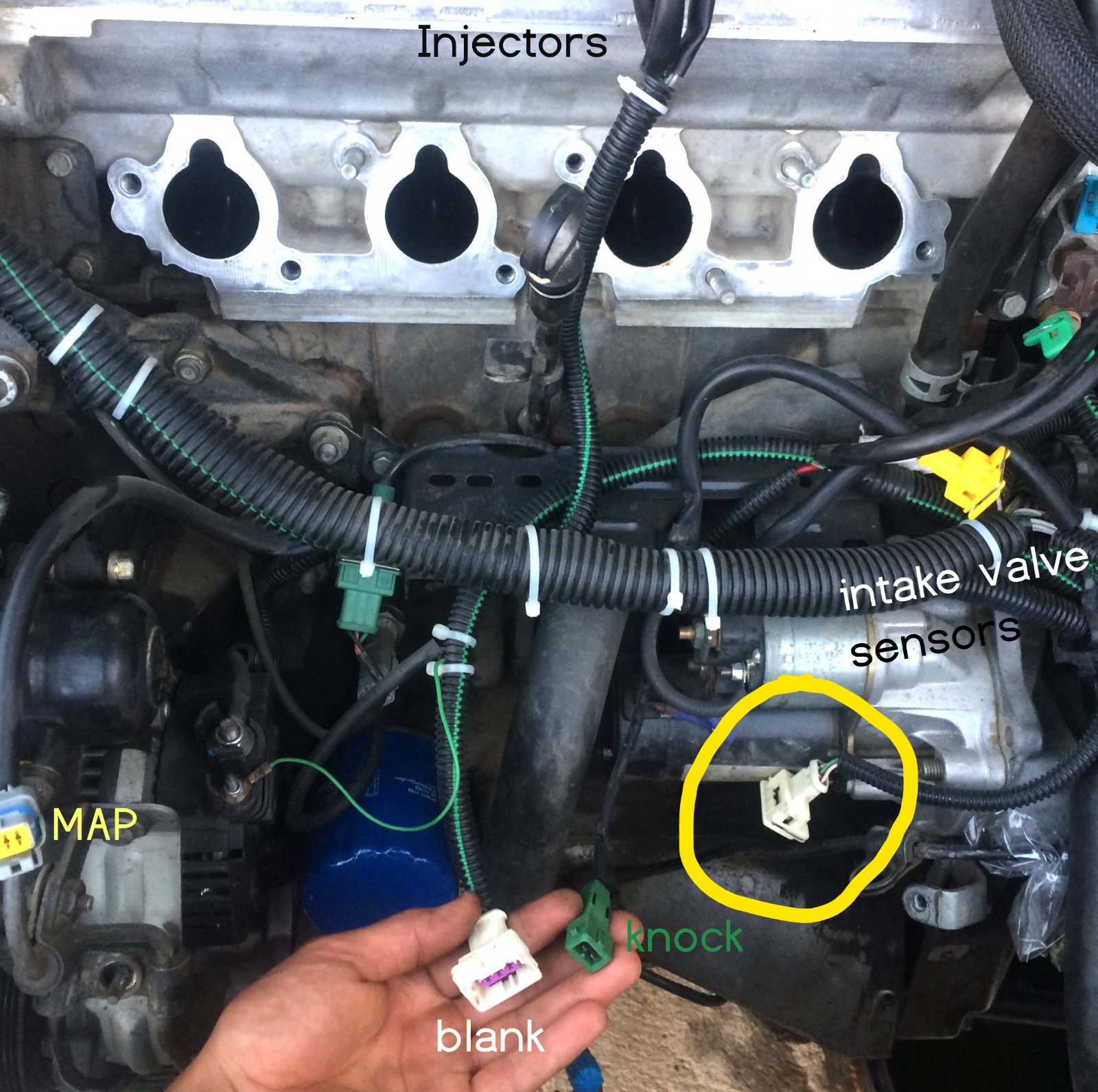

the blank connector can't reach speed sensor, cos sensor is behind engine
that is a pic from wiring harness

What about this plug? looks like it could maybe reach over the top of the gearbox?
The plugs must be there unless someone has cut them off. The speedo would never have worked.

wheeler wrote: 08 Sep 2021, 18:04 What about this plug? looks like it could maybe reach over the top of the gearbox?
it is one of the intake sensors connector

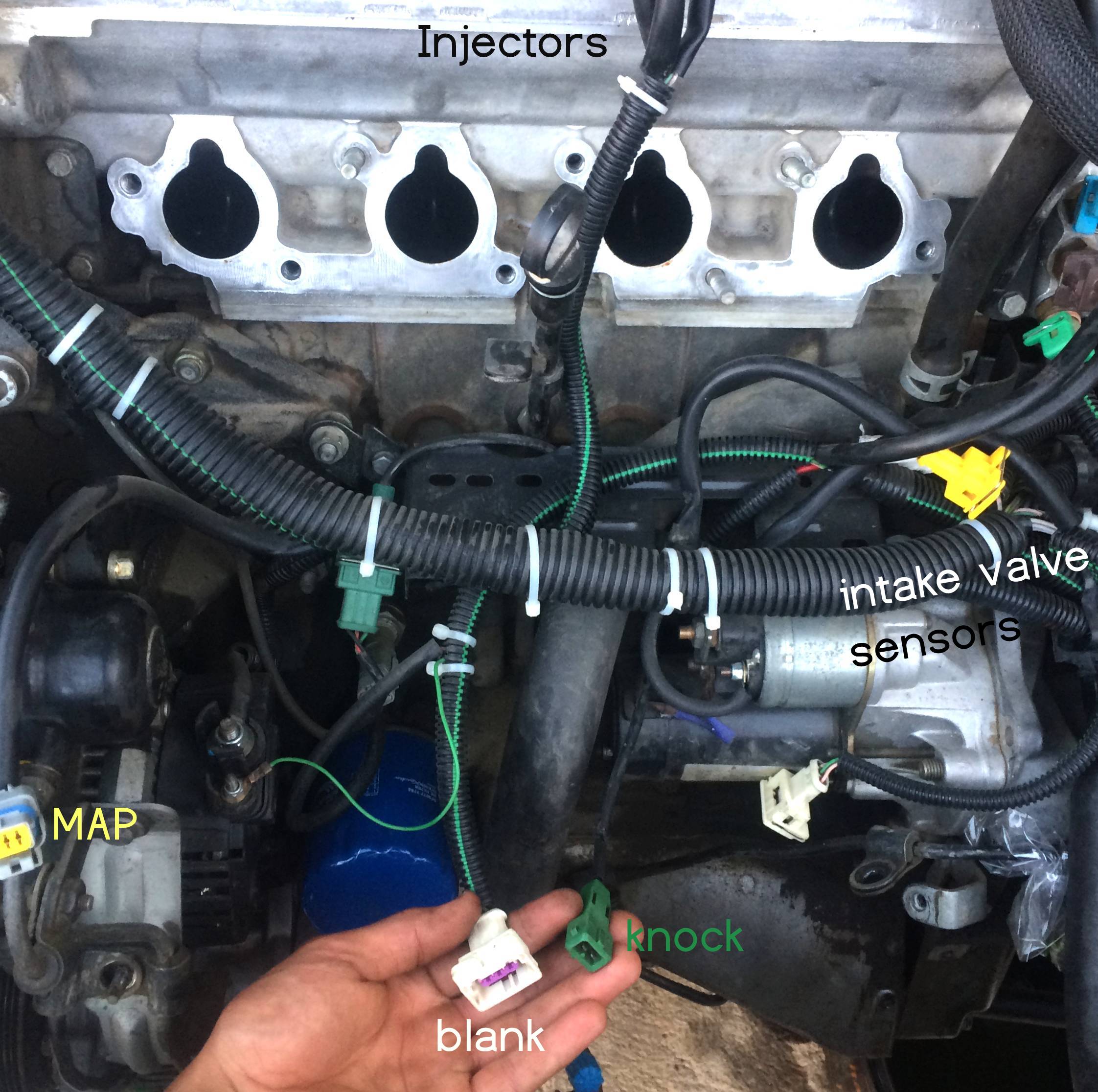

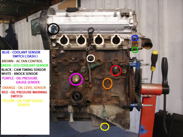

update:
it is not knock sensor, actually it is oil level sensor
as shown in pic: (orange)
