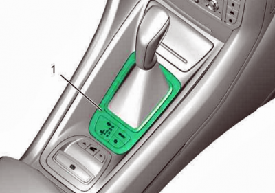

Carefully unclip the surround bezel with a trim removal tool.

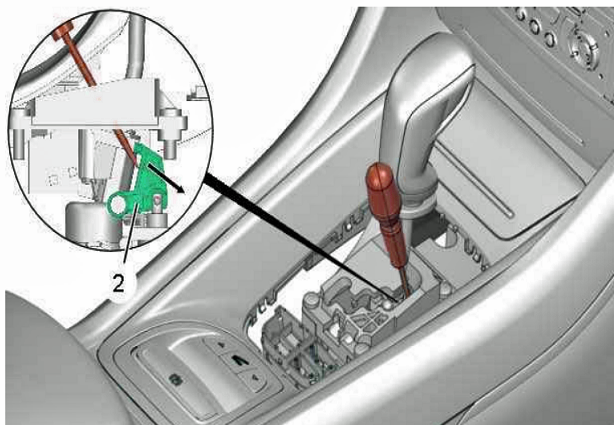

Unlock the "shift lock" with the aid of a screwdriver - Press on (2) in the direction of the arrow. Move the selector lever to disengage it from the "P" position.
So keep a screwdriver handy in the glovebox just in case it gets worse. You may find the mechanism is a bit worn on investigation.
