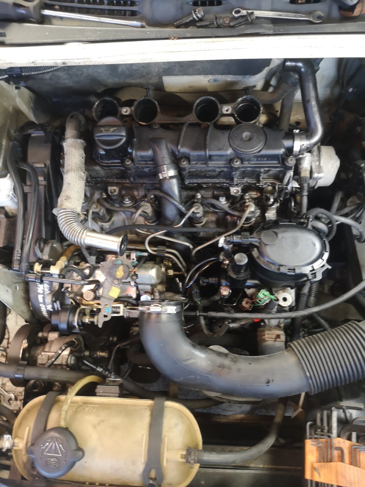

Picture below of the engine less upper inlet manifold/EGR.
