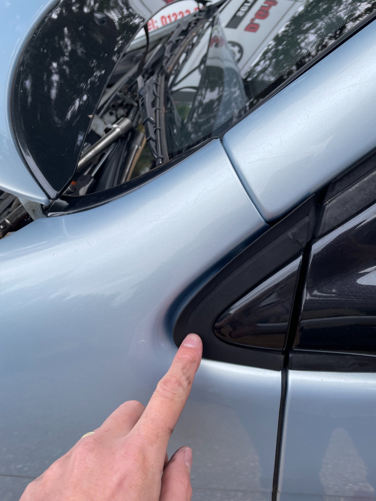

I noticed that when my sister’s C5 was down with us for a clutch, gearbox and flywheel that the rubber trim had torn nearly completely off on this pictured piece and is missing entirely on the other side:
Can someone tell me how the triangular part with the rubber is attached to the car? I am going to try to find replacements but can’t work out if it is something I need to fit when I next see it or can post up.
Sadly they are no longer available from Citroen so I will try a few breakers.

Oh and is it possible that someone can tell me if the part is the same across Mk. 1 and Mk. 2 C5, please? I noticed that the Mk. 1 is quite glossy but have seen pictures when looking for breakers on eBay of the part looking quite matte.

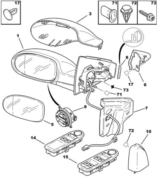

If it's item (6) - the rear view mirror finish, then this part is the same for the MK I & II.
Item 6 is part 9015N4 for the left and N015N5 for the right side.

Yep, number 6, thanks.
And I can now see that it is secured by fastener 17!

654720 is the part for the closer (item 17) fastener size: DIAM 5 H 15,5 which is available at £1.07 each from Citroen inc. VAT.
I've added the part numbers to my earlier post for you.
