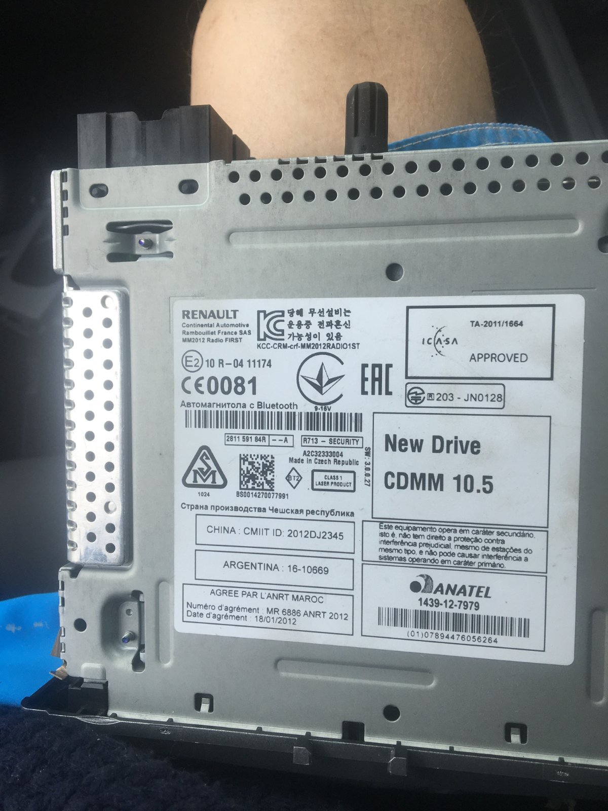

Hello,
I have the megane dynamique 1.5 diesel 2014.
Im trying to swap the radio for an aftermarket one...
I have the fascia to accept an aftermarket radio but cant seem to find a set of connector adapters for it...
Has anyone see any around that would fit the connectors in my car?
Thr auto audio shop sent me an adapter kit with the fascia but my connectors dont fit ...or it doesnt fit my connectors!

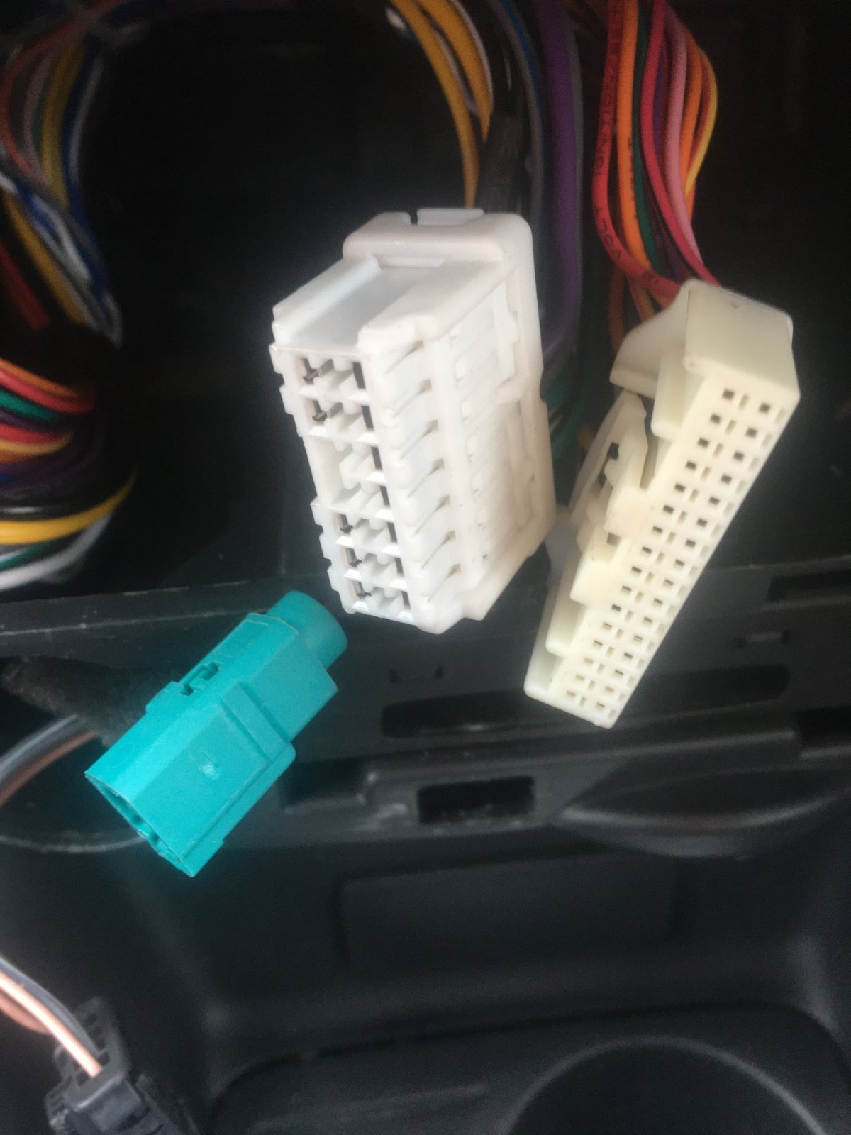

I have two white block connectors coming off my harness.

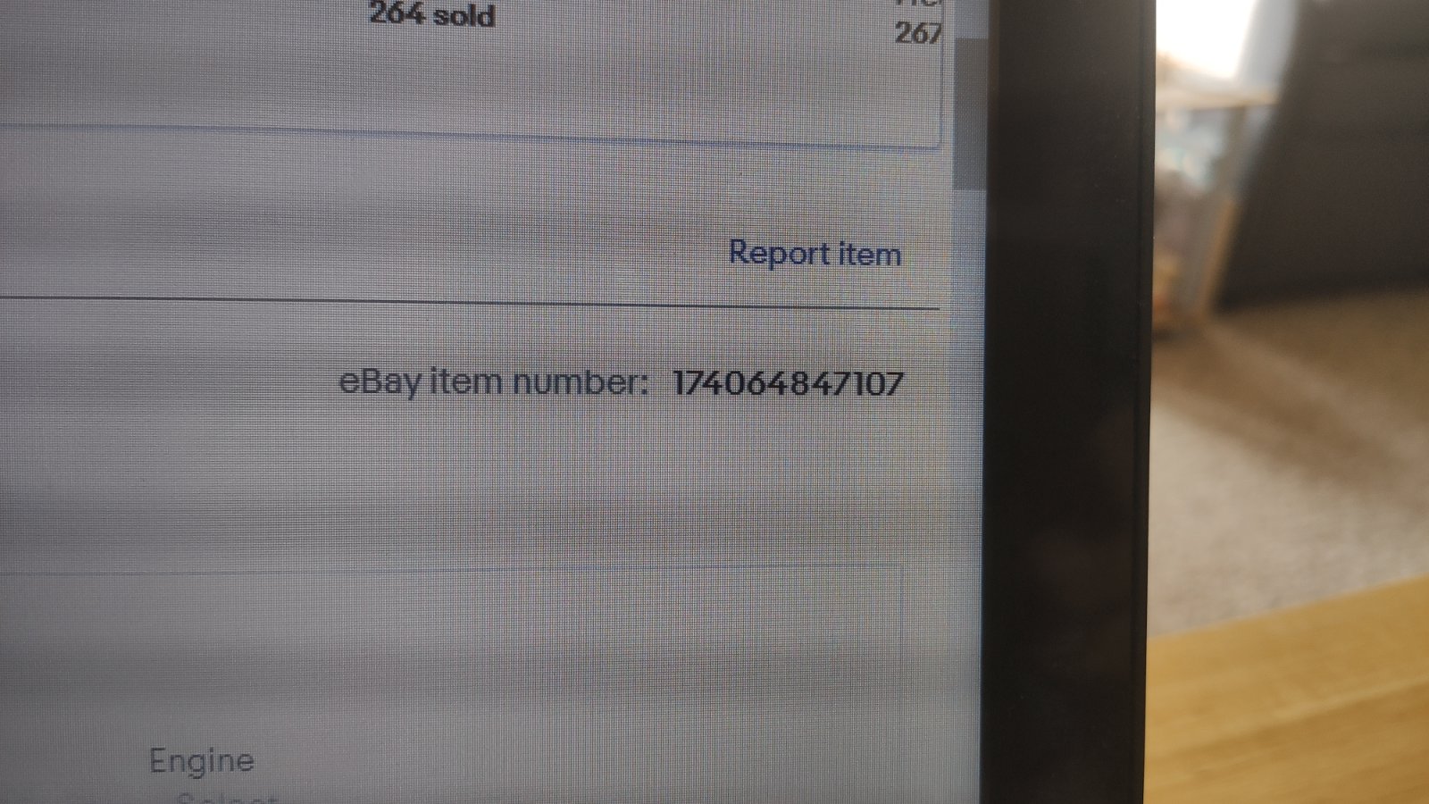

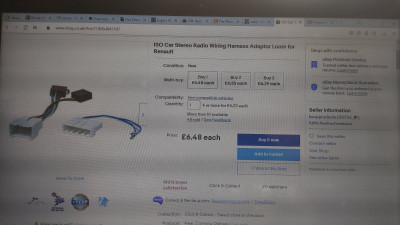

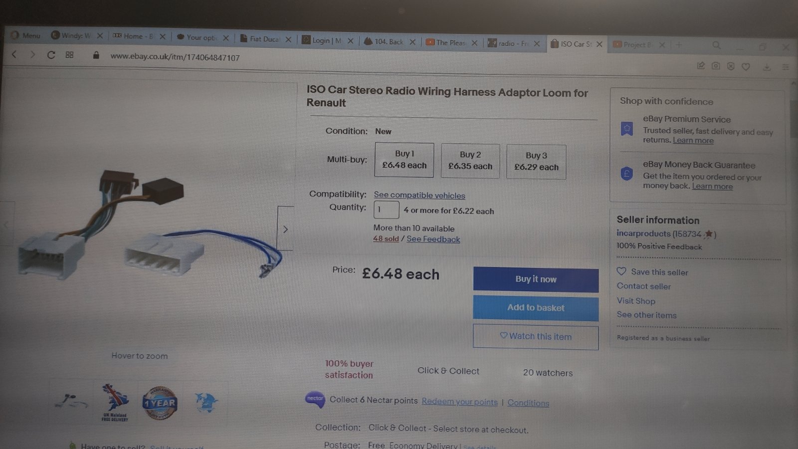

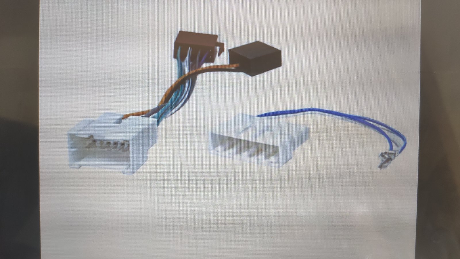

You might want to look at something like this harness to fit your white plugs and adapt to ISO plugs. The ebay number is in one photo. Silly question, do your white plugs attach straight to the car harness or do they go back to another connector?

Dormouse wrote: 28 Aug 2021, 18:20 further investigation shows there is separate radio/satnav/audio ecu on the megane so this one is over to the experts
Hello Dormouse...
I'll check to see if the wiring has another connector further up the harness...
Its the connector with about 32 pin...or pin holes thats bothering me....
The other connector with less pins seems to be quite common.
Thanks for the help and reply btw....along with the others who replied.

Re: radio
I'm wondering if there's a separate connector that you can buy to replace however the sat nav connects and links to the radio?
There doesn't seem to be much info circulating about how to do this.
I suppose there'll be an item for the job but it's sourcing it!

Re: radio
I found this pic for your 14 pin and 32 pin connectors. notice the lack of cables in the 32 pinner
The brown plug is speaker connections, the black plug is the power connector and I suppose the blues and whites are going to be unit interconnect/control wires but without a meaningful wiring diagram I couldn't guess.

I saw an item on ebay...
https://www.ebay.co.uk/itm/203513550358...
I think it may be the correct item but the price is shocking!
