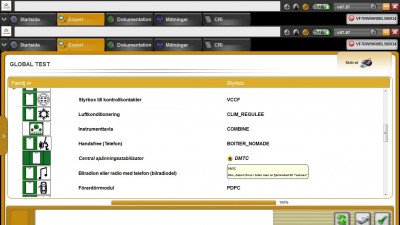

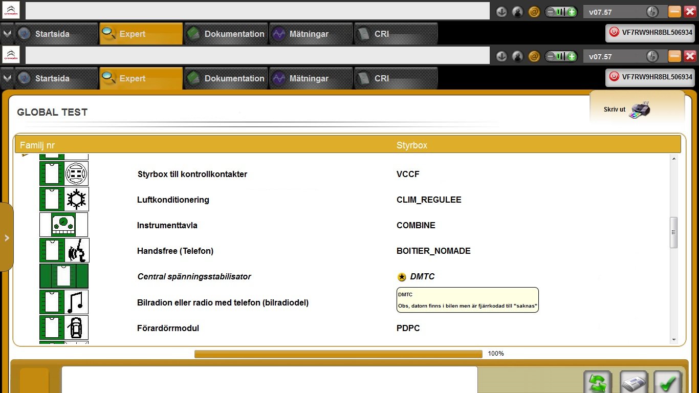

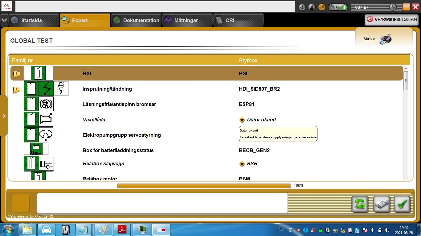

I seem to not be able to do any programming with Diagbox.
The gearbox ECU (computer?) is not recognized - no name. See the pictures.
Nowhere could I do any programming or basic settings - "This computer does not allow it" was the response.
So I took out Autel.
I was able to do one thing succesfully but after that the fault codes P0949 and P1800 came up.
It was called "Complete programming" - and it did try to program the Neutral position - I got "Completed" in the end. Where as, all the other options stated "Not succesfull".
On top of this - two new faults were precent (we lended the car out for couple of days):
P12A5 Cyl2 low quantity of fuel or low compression, Intermittent - I guess when it says "Interval wiping" it is suppes to mean intremittent...
P1445 Particulate filter needs changing
gearbox ecu unknown and in safe mode: This one is the the Central voltage stabilizer and says: computer precent but remote programmed missing What are all these options in Gearbox in Diagbox - none of them worked and Autle only had 3: And last question:
Where is the best place to find what gearbox a vehicle has? Is the one in ours called AM6? Other places call it 6MT.....
Thanks

Well its not the AM6 or the AL4 as these are both proper auto boxes. The CFC300P I think is the only one there that is a piloted manual box.
- x 6950
Re: C5 only 1, 3, and 5 gears work, in both manual/auto
If you look back to my previous post, you won't be able to programme the gearbox ECU if there is a communications fault - the same problem that is likely preventing communication may be what is preventing Diagbox with 'talking' to it. So I would go and double check the actual connection on the gearbox ECU - specifically the pins in the connections as these have been known to come loose inside the socket.
wheeler
- Posts: 7938
- Joined: 21 Sep 2002, 19:07
- x 1061
Im not saying that there is not another issue here but just because Diagbox doesn't identify the exact ECU doesn't mean that there is a problem.
Its not unusual to see this on Diagbox, even when scanning a vehicle with no known faults. I find ABS/ESP systems seem to be the worst offenders with this.
If there was a communication problem issue I would expect Diagbox to say no communication rather than ECU not identified.
If you are able to read fault codes from the gearbox ECU? then i would say you have communication with it?
