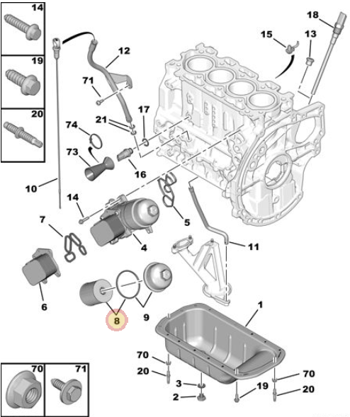

Here you go:
You have 2 choices, an OEM original filter, part: 1109AY, priced £15.66
or an OEM cheaper alternative, part: 1680233480, priced £7.96
All direct from Citroen and VAT inclusive as of today.

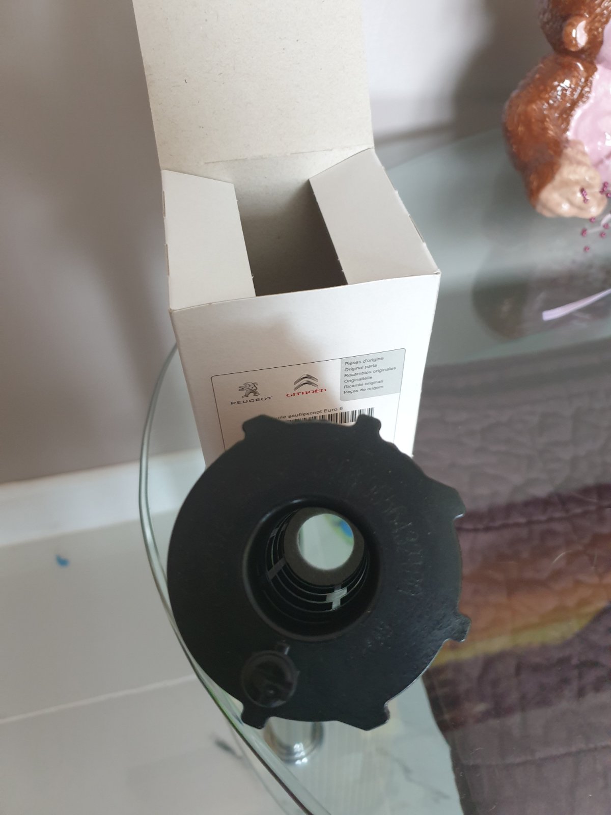

Re: Low oil pressure
Have a look down the middle hole on the filter & check that the plastic cross in the middle is not broken. This happens even on the genuine filters & causes low oil pressure warnings. Usually happens within a day or 2 of replacing the filter.

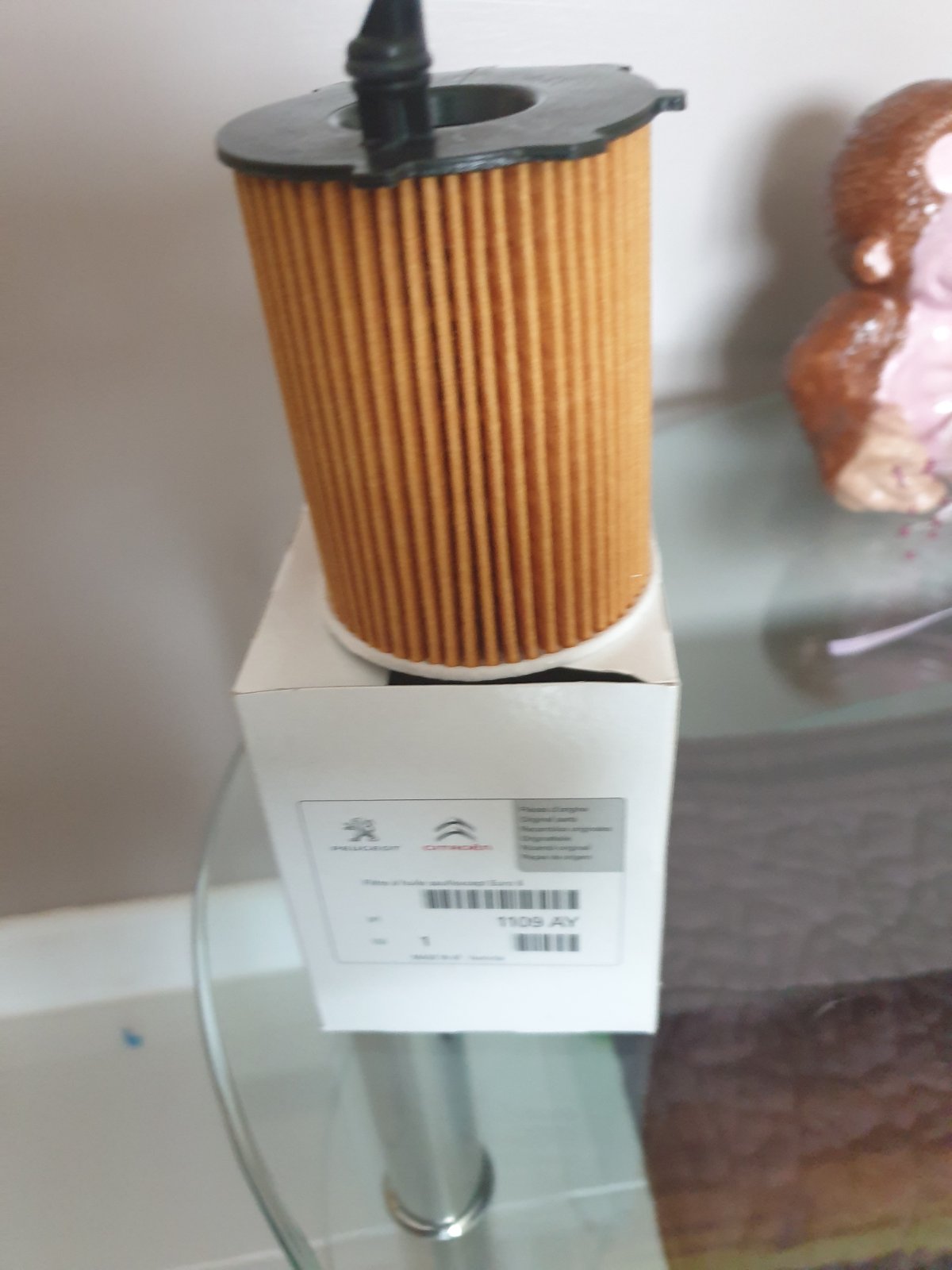

Have checked filter looks good but I had heard non genuine filters can cause this. I have just ordered a genuine filter will try that thanks again Marc for the reference.
New oil filter arrived but has no cross in the middle either hope it solves the problem

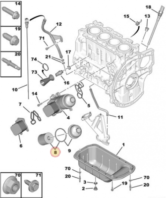

Hi Marc what is item 6 in your diagram
Item 6 is the oil to water heat exchanger (oil cooler) which is fitted to some engines, while others have a blanking plate in its place, depending on engine specification.
