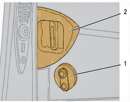

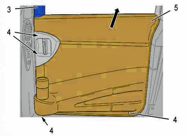

Anyway, I am really annoying squeaking side door panel, and I wondered if any of the FCF Oracles were able to post a schematic of the screw parts (as when I looked I couldn't see them all...), Secondly I also understand the door trim can be taken off with the side door in situ?

Ok, here you go:
Remove:
  • The window winder (1)
  • Finisher (2) of interior handle
  • Unfasten the trim (3) of the front door pillar.
  • Remove the mountings (4).
  • Unfasten the panel (5) around the edge, not forgetting the central clip .
  • Remove the panel (5) by sliding it up.
Note: When refitting the door trim, check the positioning of all the fastenings before clipping them in on the door.
