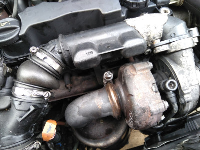

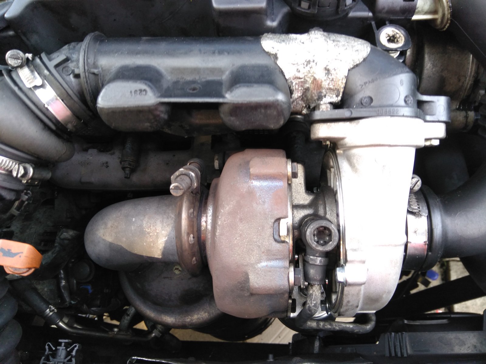

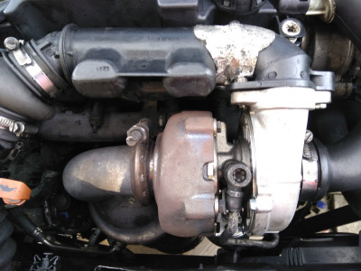

the joint between either my turbo and manifold, or manifold to head is blowing on my 207 hdi
looks fairly easy to get the turbo off, helped on this car I am sure as there are no heat shields fitted
I have both gaskets already
easy job or not?
easy job or not?

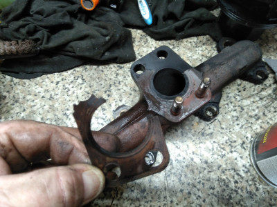

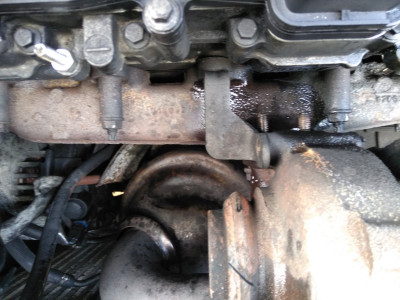

done it

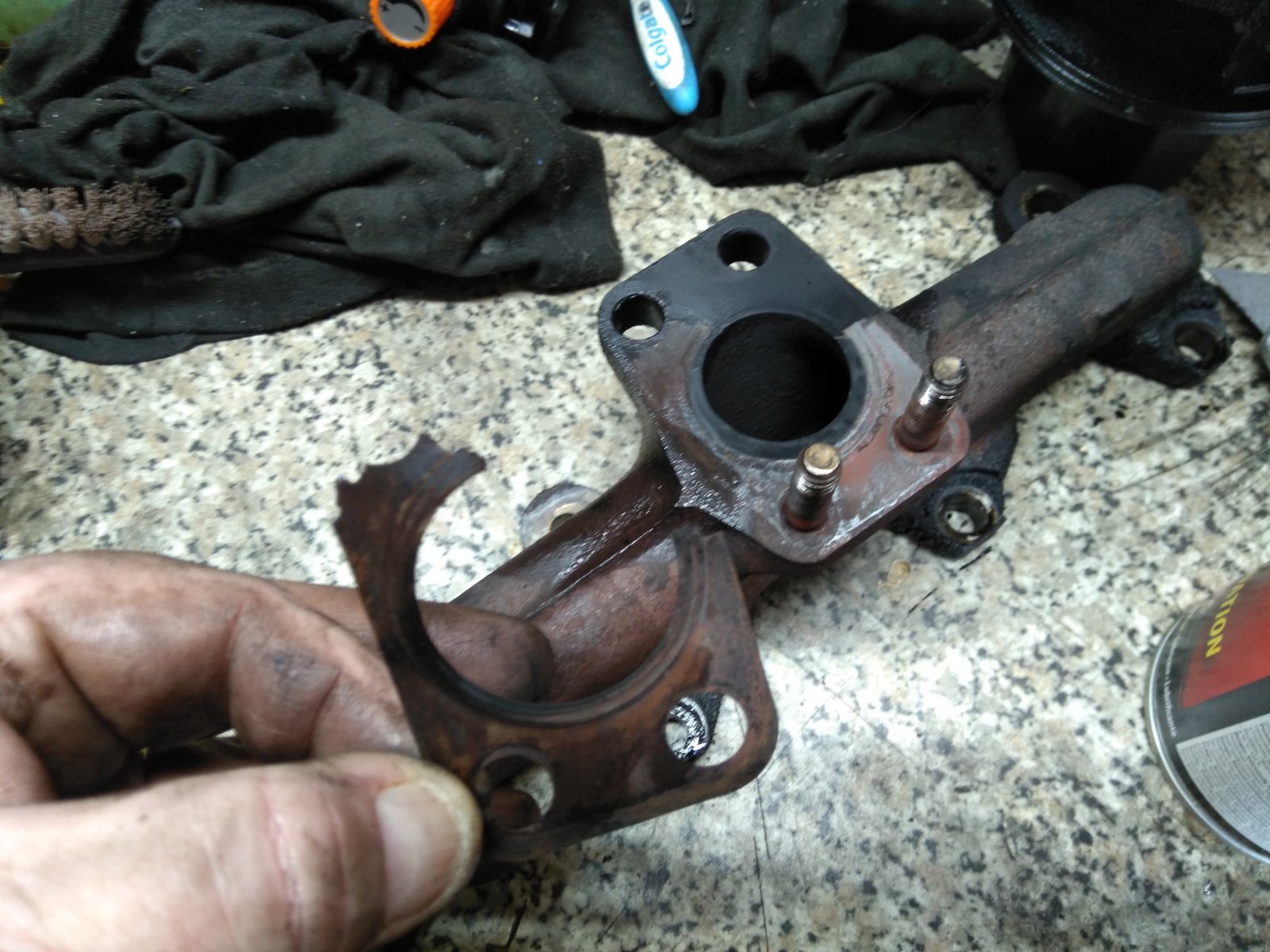

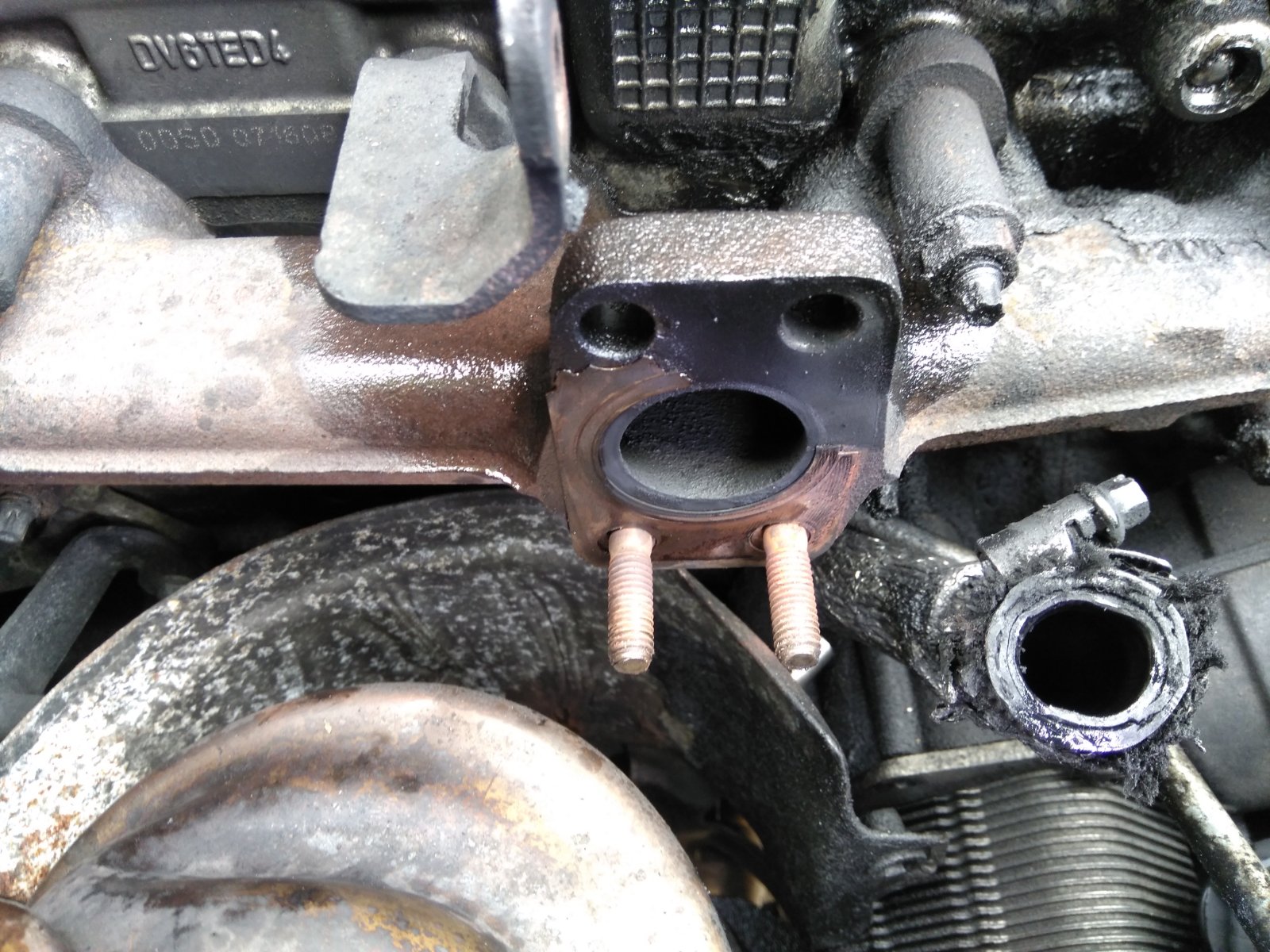

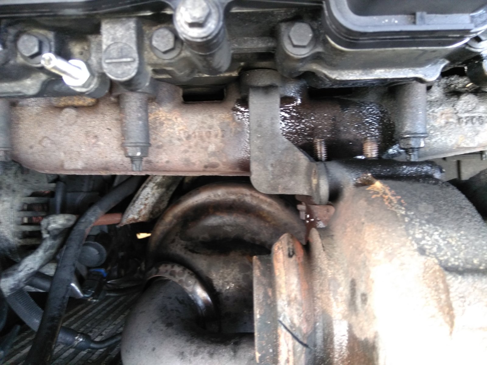

the gasket between turbo and manifold had failed, in fact half of it was missing.
while I was there, I did the manifold to head gasket at the same time

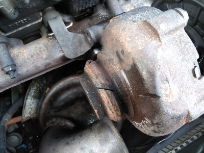

at first I thought it was this, last "mechanic" has cut the clamp/heat shield off and caught the turbo outlet, there was no carbon coming from it so I later filled that slit with chemical metal ****
removing turbo nuts was fiddly

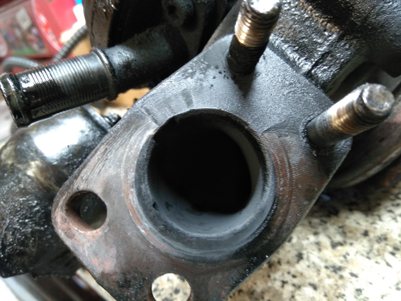

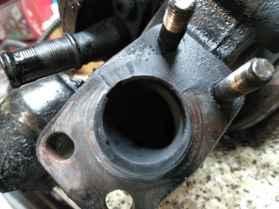

this is the joint that failed, it cleaned up well afterwards
the failed gasket still on the manifold
no wonder it was blowing
cleaned up nice

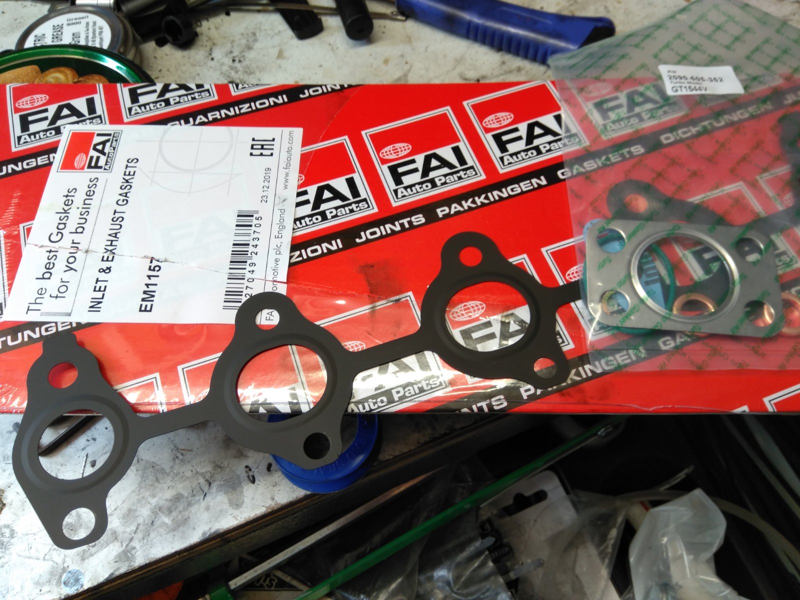

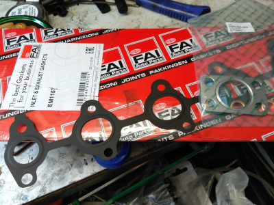

new gaskets
after lots of swearing and struggling, and less faffing about with oily hands with my camera, its all back together but still seems to be blowing a bit, very noticable when AC kicks on and off, I think the flanges mustnt be very flat between turbo and manifold, a softer, perhaps copper gasket might be best but it will have to wait now my patience is wearing thin but at least I know what the job entails.
am totally covered in oily carbon, as are my tools, but I have done for the day now and will start the clean up operation on my tools tomorrow.

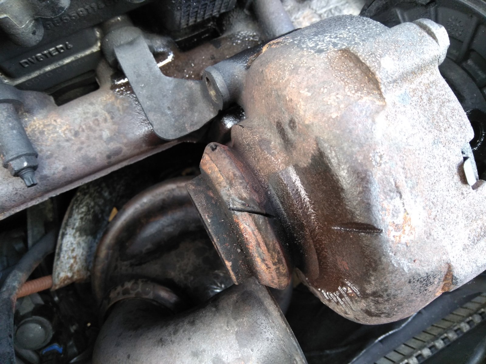

***** probably next year, I will get a replacement turbo, although that crack isnt leaking its not going to be doing any good and could lead to further cracks forming due to the heat strett on the turbine housing.
cleaned up nice
new gaskets

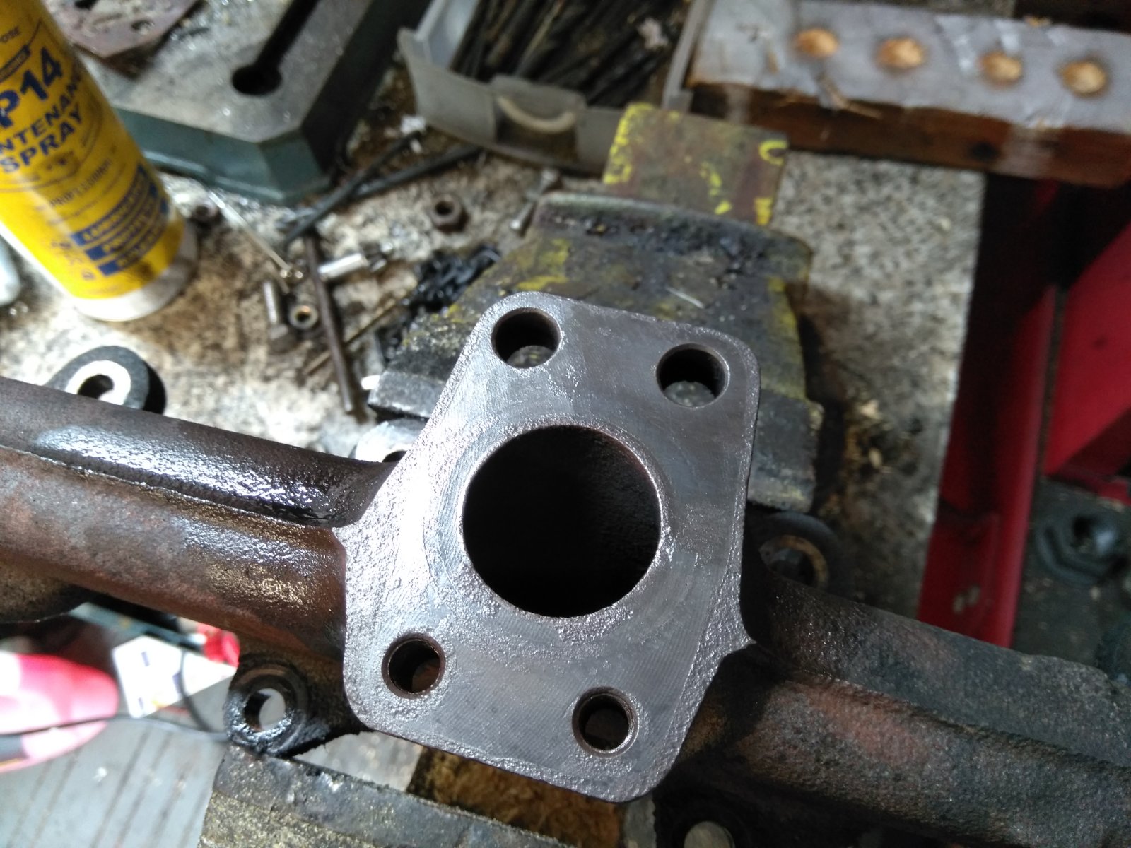

the tin "gasket" I bought I have never, ever had any luck with them in any car that had that type of gasket used in the exhaust system. I am just going to make my own from some 1.2mm aluminium sheet, that will be soft enough to take up any imperfections in any of the mating surfaces.
its just annoying that I spent a whole afternoon on it, but doing it a second time will be easier as I wont be needing to do the manifold.

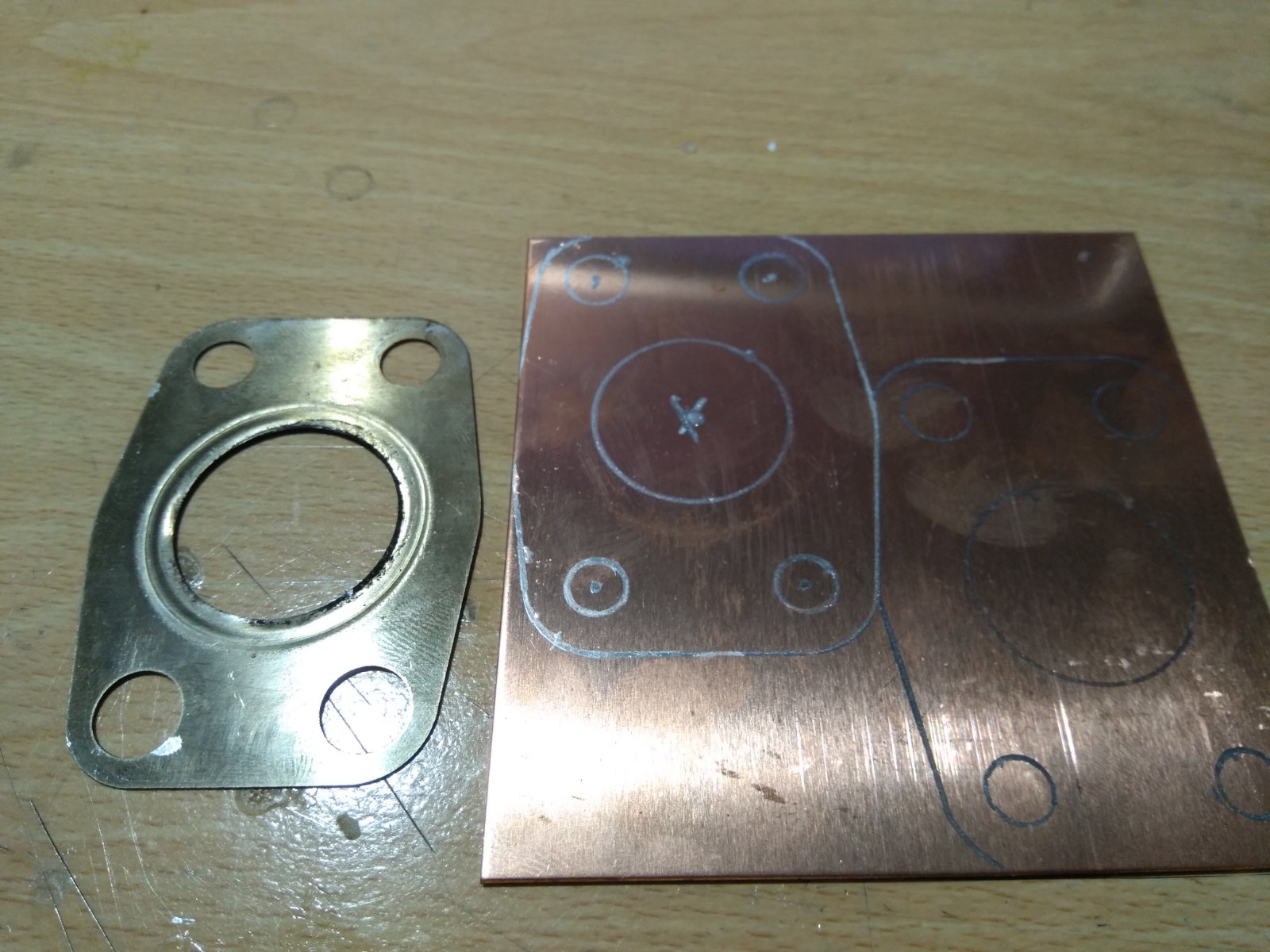

a replacement turbo has come my way from a mate who breaks cars, its from a ford with same engine and bhp. I think its a chinese jobby but its almost new, it was fitted to his own car and the gearbox went, so he just stripped it. I got the ex. manifold too.
I have taken my old one back off today, I am awaiting a piece of copper to make a new sealing gasket with, in the meantime I wanted to check the turbo oil feed for flow, is there a fuse I can pull that enable me to turn the engine over without it trying to fire?

Re: remove hdi turbo and ex. manifold, easy?
Copper gasket a good idea, 1mm+. It should anneal/soften itself with normal use, so retighten after first using.
Use a thin coating of LiquiMoly exhaust sealant (Auspuffpast - I kid you not) on both sides of it.
Brass double-height nuts a good idea to head off future seizures.

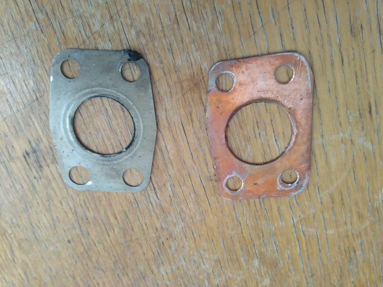

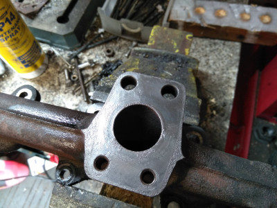

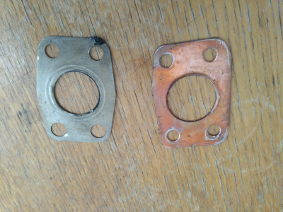

this is the gasket I want to renew, the copper turned up by courier this evening
will get two gaskets out of it if I am careful
its 1.2mm thick
I also have some alloy same thickness, but an gonna try the copper first.
its 1.2mm thick

all sorted, was quite easy to make a new gasket once the holes were marked up and drilled, I used a hole saw for the large one.
all back together with this used turbo, and I have changed the oil and - not had this car long and I bought it cheap with problems, one of which was oil coming from all over, each time I have fixed something leaking its been cleaned and run up to temp and then see if anything drips off the bottom of the engine, its all stopped now.
diy gasket on right
diy gasket on right

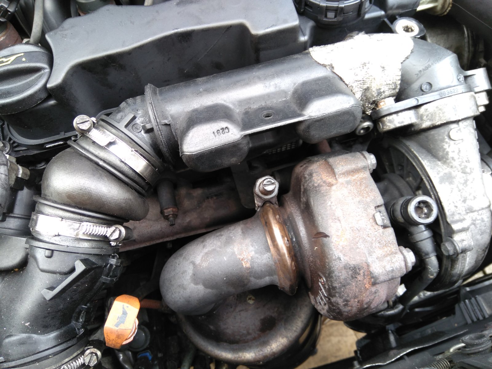

upon cold start, there is a puff of smoke from the dpf to turbo joint, the v band clamp doesnt go all the way round the joint leaving around 20mm unclamped - I will get a pic tomorrow
I undone it slightly today and moved it round a bit which seemed to be better.
should the v band clamp go all the way round the joint, they all look like there is a gap and some clamps I have seen look to have a larger unclamped area than mine.
I did seat this top joint first, then the two mid way 13mm nuts to the block [actually could only reach one, gearbox side of dpf] none of these nuts were fitted when I first did the job in my opening post. and finally the clamp to exhaust pipe last.
I will get image tomorrow, and possibly a video of its first start.
can a smear of paste be put into the joint if I get it apart again?

The V-clips don't usually go all the way round. If a small gap, try adding some exhaust paste (Holts FireGum used to be good, or the LiquiMoly same) in decent thickness.
