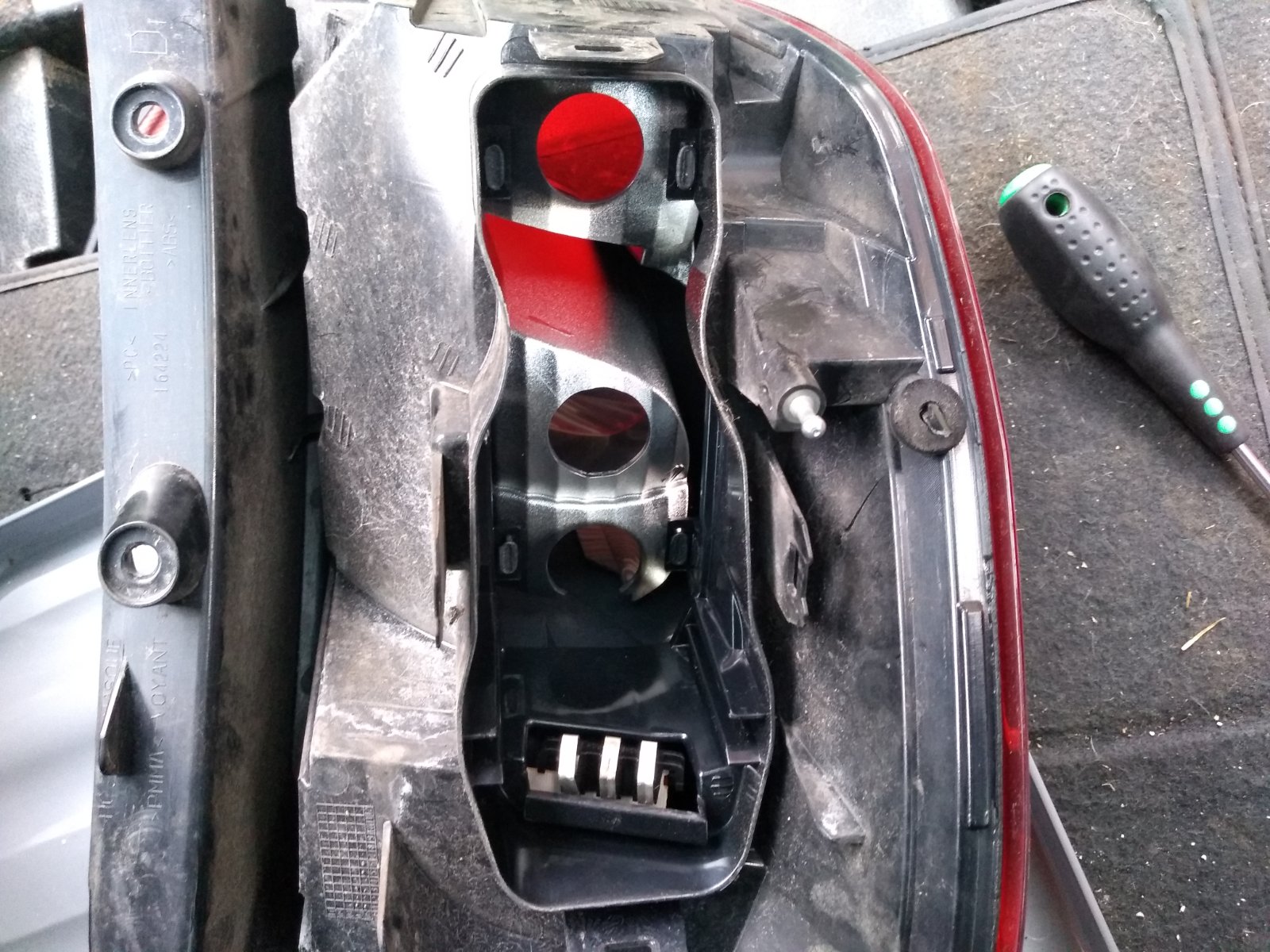

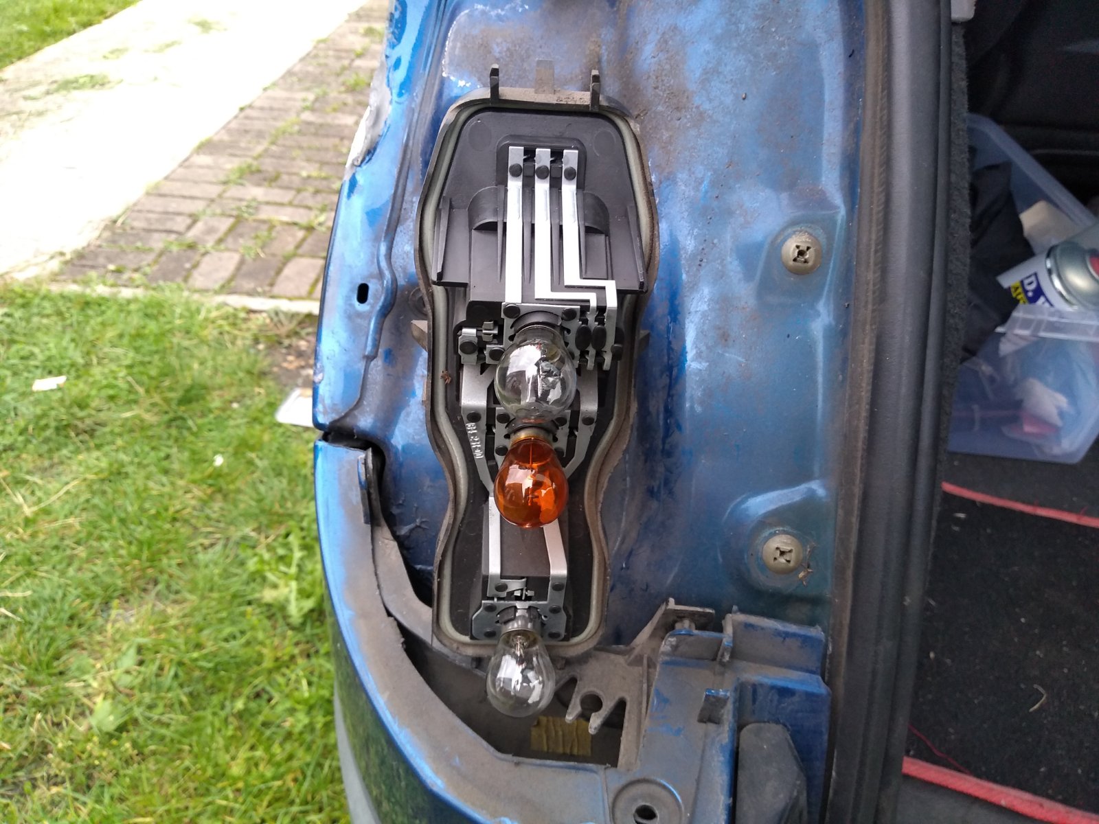

hi got a grand scenic 2 07 plate but oddly enough have to fog lights and 3 bulbs per cluster and no reversing lights bulb holder at all can someone poiint me in the right direction as in rear light wiring diagrams please also i add photos just in case

solved i put in new reversing light switch and rear wiper works and epb ok as well
