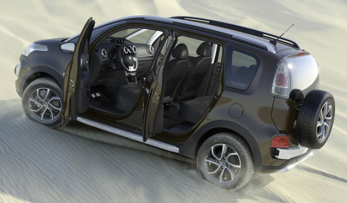

First, to avoid any possible confusion I have modified your profile and the thread title / post to remove any references to 'Aircross' as the European and non-Mercosur country models of the C3 Aircross were not launched until 2017 and the C5 Aircross until 2018.
What you have is a the special edition of a C3 Picasso from which they developed an SUV specifically for Mercosur countries, made in Brazil from 2010, so won't be a model familiar to many outside this region:
Thought I'd just clear that up as this model was not available elsewhere and may of caused some confusion being a 2014 model.
Second, if you pop your VIN up (automatically masked on post submission) I'll see if I can clarify model and engine - but there is a chance it may not come up with Citroen Europe.
