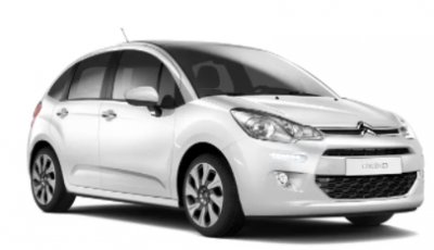

If you have an A51 C3 like this:
.... that has Stop and Start system then it will have a reversible alternator which is a specific requirement for this vehicle. You can't replace it with a standard alternator. The specific type of reversible alternator is also dependent on the engine fitted, so best check with your dealer.
