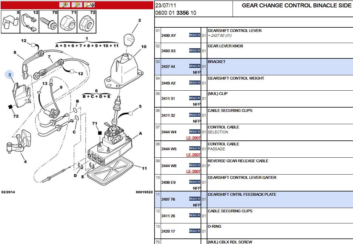

Hello again. My poor sister has had another issue with her 2001 2.2 manual C5!
It has always had a very occasional pop out of 1st gear and she said that this got worse and then stopped selecting gears. She managed to nurse it home in 1st gear after some persuasion.
I am suspecting that it might need new gear selection cables— I understand from a brief read on here that there are two. Or, if she (me!) is lucky, just the cable set up or reattached.
Can someone kindly provide me with the part number and the diagram for these? Also, is there a removal/installation and set up procedure which details how to change them and set them up right?
Oh, and which gearbox has this car got too, please?! ML5T, ML5C, BE4R, ML6?
TIA

Hi James,
Parts diag and part numbers herewith, #7 #8 #9. All still showing available.
From the VIN, gearbox is ML5C.
Marc will probably be able to help with any setting procedure.

Thank you very much Chris.
Yes, the set up procedure would be good to know too.

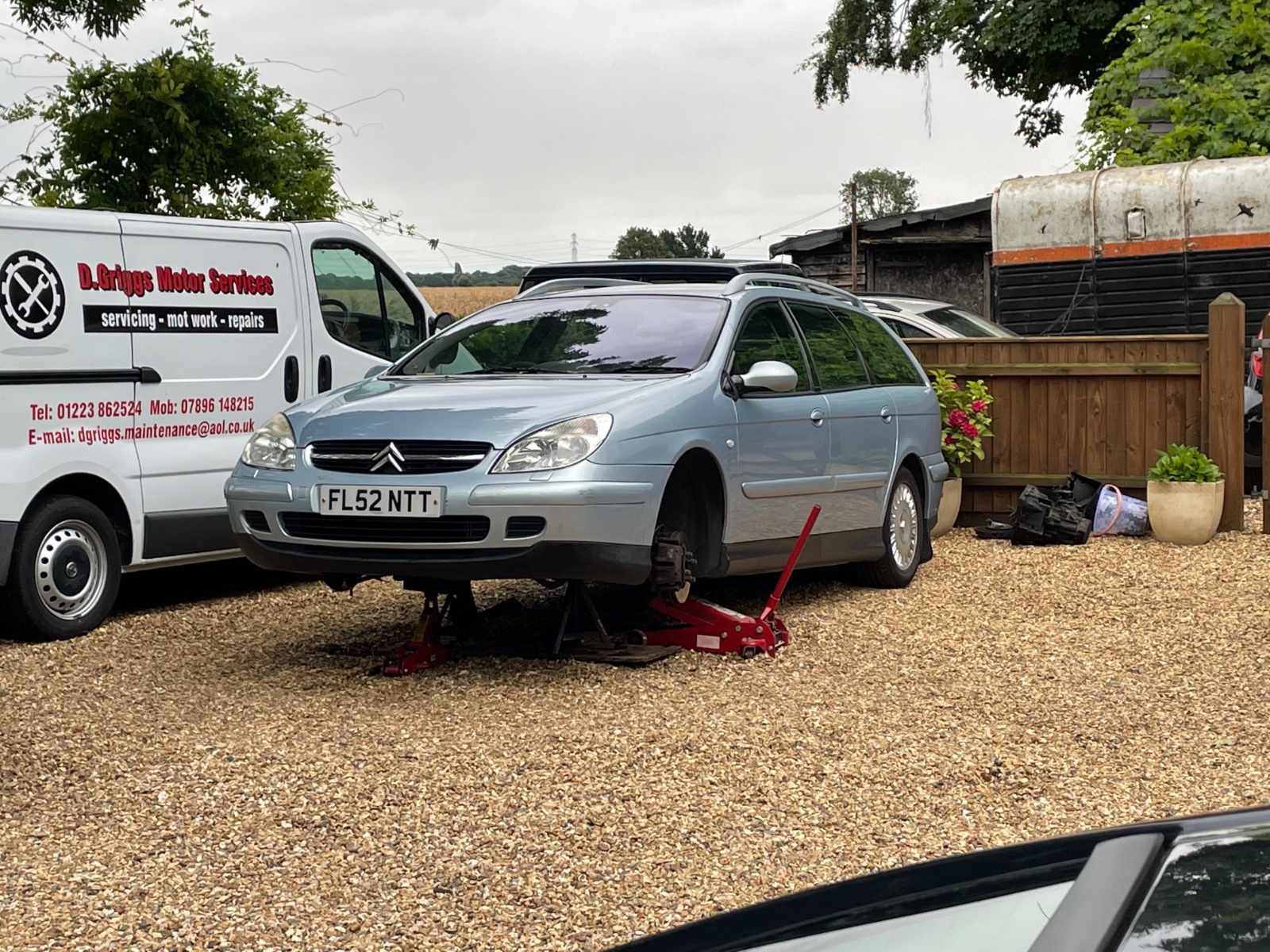

Well this has escalated!
The car is going to come south for a replacement gearbox from a member in Norfolk.
I know it is usual to replace the clutch and maybe flywheel when the box is apart— this will probably be skipped as this was all done quite recently by the previous owner’s garage when it had a a dual- to single-mass flywheel conversion done. Unless there is some horror found when apart of course!
Correct oil is on order with AEP: Total Transmission BV 75W80.
Anything else I should be considering while in here?
Any seals that should replaced as we go?
For example on the drain and fill plugs… or the reverse light switch which looks like it may have to double up as the full port after reading about the job on here!
P.S. I will be assisting but the work will be done by mate, a proper car mechanic.

So this was the clutch which let go— very apparent when box and engine separated! It had a very cheap single flywheel conversion— not branded LUK or Valeo and PO was proud of its cheapness but life was about 2 years on this cheap s**t. Garage up north and RAC man both said the gearbox was dead which it actually wasn’t.
Dual-mass flywheel reinstated, clutch replaced and replacement gearbox in stalled anyway due to occasional 1st gear selection issues in the past.
My mate did all the work really and I’m looking forward to driving it north do drop back to my sister.
