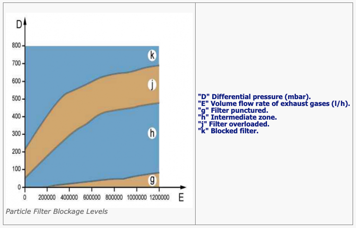

Does anybody know how to judge the pressure differences across a Diesel Particulate Filter? I appreciate the cars computers will try to initiate regenerations to keep the DPF working as best as it can, but I was wondering if anybody had any sort of chart that would indicate limits or zones so I could plot the differential pressures I get during diagnostics and see if my DPF is healthy or ailing...
A long time ago I did find the chart attached but, judging by the flow rates, it must be for some kind of huge engine. I also found a set of maximum figures for a BMW but I would think limits are specific to each engine. I'd like to find some figures for my 2.0HDi so I can keep an eye on the DPF condition each time I service it.

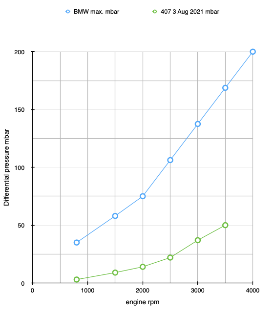

When I run diagnostics on my 2.0HDi I record the differential pressures at a range of engine speeds. When I plot these they're well below the maximum figures I found for the BMW engine but are they respectable? I suppose no warnings on the dashboard suggests they're not bad and I'm concerning myself quite unnecessarily, but my cunning plan :-k is to plot figures at each service so I can see if there's been any deterioration and hopefully nip any issues in the bud.

The differential pressure sensors on this engine operate within these parameters:
Key
"C": Sensor output voltage In volts.
"D": Pressure in Bars.
They only operate from 0.5 to 5 Volts:
Voltage supplied for a differential pressure of 0 bar: + 0.5 Volts (engine off).
Voltage supplied for a differential pressure of 0.9 bar: + 4.1 Volts (particle filter clogged).
You also need to be aware that the differential pressure sensors are not solely used to determine the state of the DPF. The amount of particle filter additive that is injected into the fuel system and ultimately the actual particle filter is also recorded in weight (grammes). At some point, according to a pre-determined weight, the engine ECU will flag a warning as to when it estimates the particle filter has reached end of life and needs replacing (or cleaning) based on the amount of additive injected. There are components like Cerine in the additive, engine deposits and ash that cannot be burned off, so these all play a factor in the calculations.

The 900mbar for a clogged filter seems a high threshold (certainly compared to the BMW figures) but, as you say, there are plenty of other things being measured in parallel and it perhaps wouldn't be differential pressure at that level by itself that would tip it over the edge to light an undesirable light.
I do look at all of the figures to try to understand which way things are going. I'm not entirely sure what I would do if I saw change for the worse in the DPF. I keep a close eye on the fuelling and additive parameters each time I do a service but assuming all is well there, perhaps I'd try a few tankfuls of premium fuel or one of those special snake oils or something to see if any real improvement can be made...
