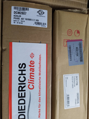

Purchased this car 6 weeks ago. I am planning to replace the AC condenser, front EGR, radiator, and a single front parking sensor.

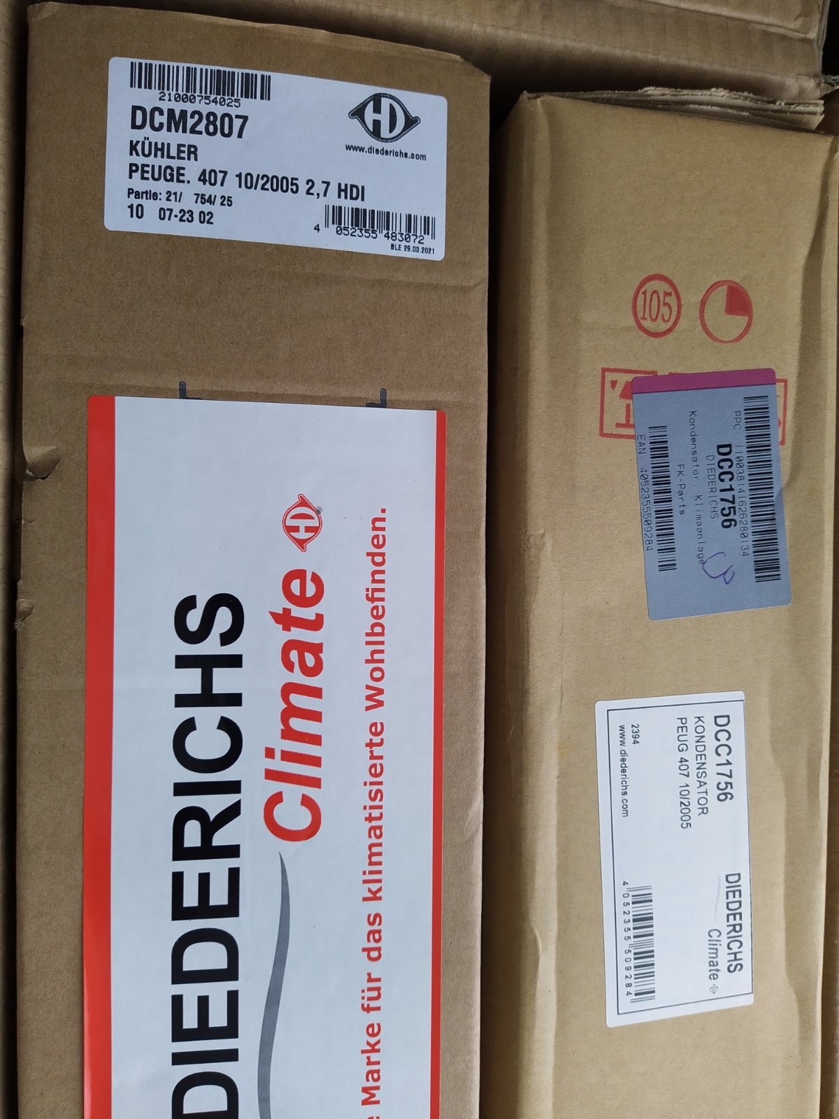

The parts arrived and the radiator and condenser say "Puege. 407" on the box. Condenser has a sticker on it that says 2.2 liter on it.
I am hoping these interchange to the C6. Can anyone verify before I take it all apart?

Ok, so the Condenser part number for your C6 is 6455EY and this was also shared with the 407 DT17TED4 2.7 and DW12BTED4 2.2 engine up to build date 11437. Your build date on the C6 is 10963, so should be fine.
Your radiator part for the C6 2.7 should be 1330P7. The radiator for the Peugeot 407 2.7 engine matches this part, but not for the DW12BTED4 2.2 engine. Looking at the picture on the box, it does show 2.7, so you should be fine on both counts.

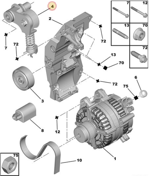

The original alternator pulley part number (5751E3) was replaced with part: 1611422780, item (3) on the diagram.
The original was priced £17.65 sterling and the new part is priced £62.64 - so a big difference.
As for the alternator belt:

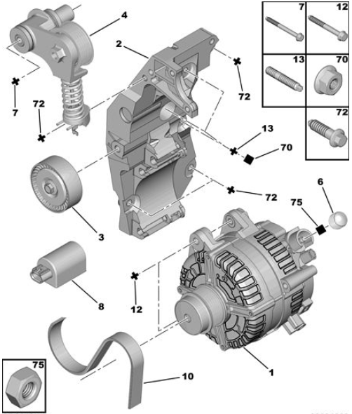

I am having trouble finding the tensioner pulley. Is it the entire assembly or just replace the pulley?
This one appears to be correct:
https://eurofrance24.com/catalog/produc ... -6a228-ae/
Is there a good diagram available?

Re: C6 part number verification
Hi Chris,
yep, that one is correct and yes, it comes as a complete assembly.
I would also recommend using a new bolt (No 7) as I had one snap shortly after reusing.
